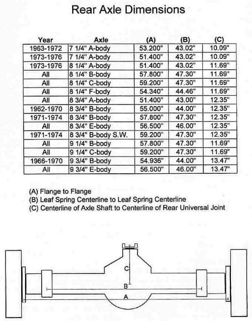

73 and 74 are wider by a couple inches
Sorry after revisiting your question I see for a 69 CBody... I missed the Fury part.
Looks like it will bolt in according to the chart the perches are the same width (special note: 73 and 74 will have a large centering hole in the perch for the ISO setup,you will need to weld in a washer or go to Firm Feel for the exact washer) The flange width is close between 8.75 and 8.25.... the real answer would be from drum brake outter surface to surface.
Dammit I'm dumb! :head_smack: The chart does not show 69 CBody.... When I get home tonight I have somewhere measurements of a 68 Newport CBody 8.75 rear I'll post for you
God I'm going nuts today.... the chart for CBody says ALL YEARS!
I will get though this day, I will get though this day.... just not FAST enough!
1967 New Yorker is same width as 70-74 E-body, even the perches are same 46".
