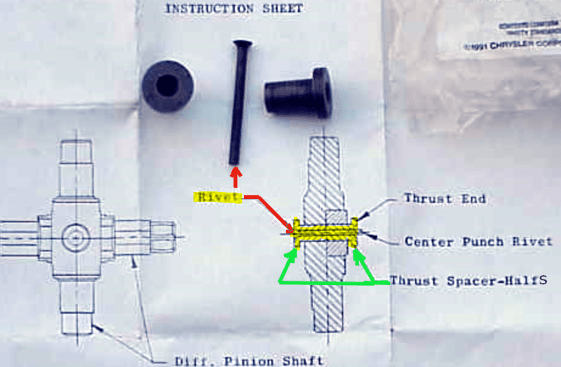

There is a thrust button inside the suregrip. The end of the axle buts against it for adjusting the axle end play. Sometimes the pin that holds them in the suregrip breaks and one half might drop out or get lodged when removing the axle.

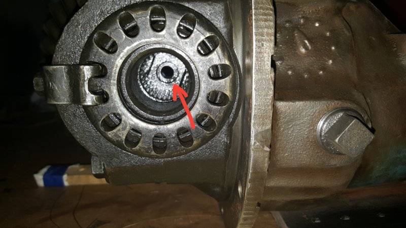

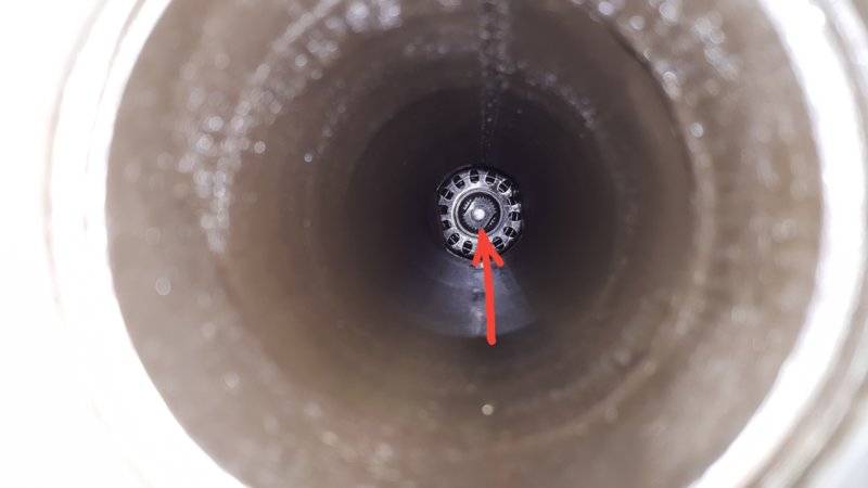

Looking into the axle tube. There is no button in this one.

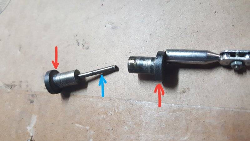

This is a set of thrust buttons with the pin that has been taken apart. The red arrows are the buttons, the blue arrow is the pin that holds them together. The buttons are inserted one on each side. If the pin is broken, one of the buttons could be stuck to the axle when removing and become dislodged not allowing your axel to go in all the way.
This is where the button is inserted. I dont have a pic with one in it's place.

Pics to come...
I was wondering that myself. I’ve heard of that If you have a pic, that’d be cool. Not 100 percent sure what exactly I’m looking for
Actually I see something down the tube, sticking out from the gear side.

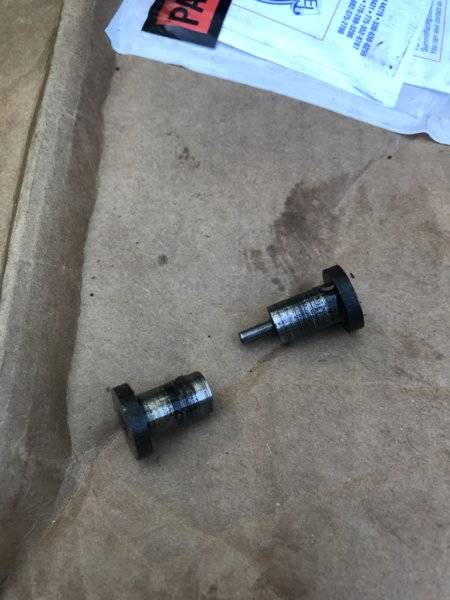

Looks like the bigger one on the right, I believe

Well, I should’ve started this by saying I had the green bearings. My bad. Kryslerkid set me straight. Can’t thank him enough! I had to punch out the pin that connected those two thrust buttons. Thank you for the input guys!
