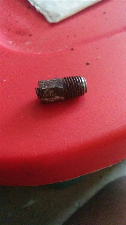

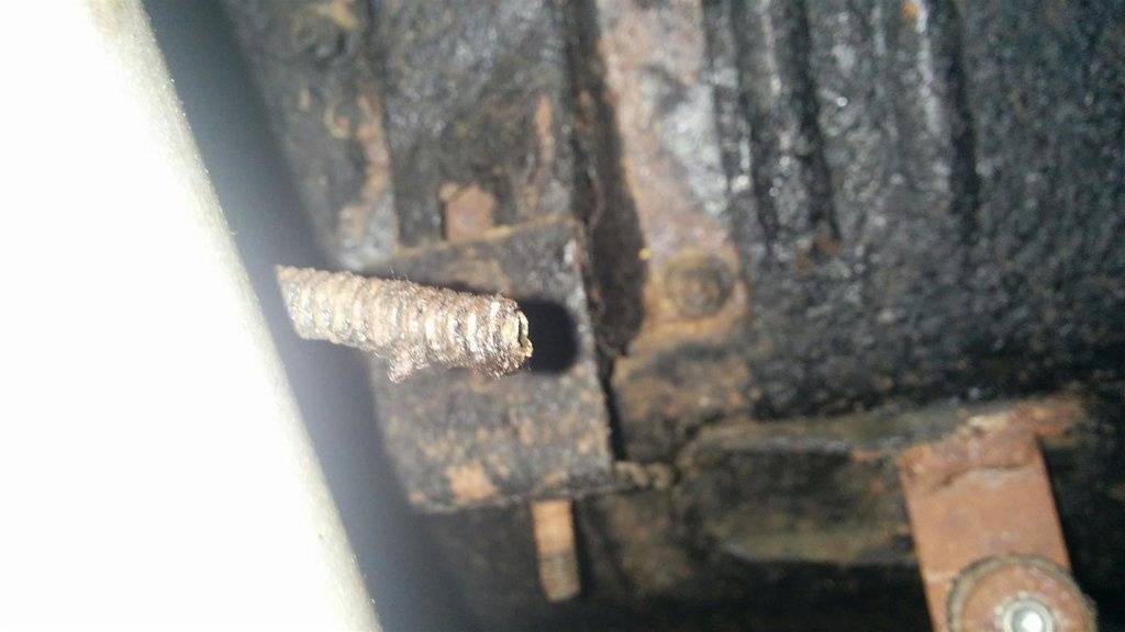

Here we are. First is the end that broke that connects to the rubber Y block hose and the second is the fitting itself.
If the original line is in good enough shape to flare, is long enough to reach, and if you can successfully remove the armor all you need is a tubing nut-from any auto parts store.
Mike
Ok great. i wanted to try that first before spending 40 dollars and hours messing with rusted clips to replace the whole line. Just wasn't sure if the brake fittings I see work since the nut part is much shorter than the original.
You'll need to find a good place on your line to cut, double flare and attach a new piece to it. Right there where it broke looks very rusted and thin.
