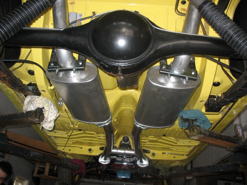

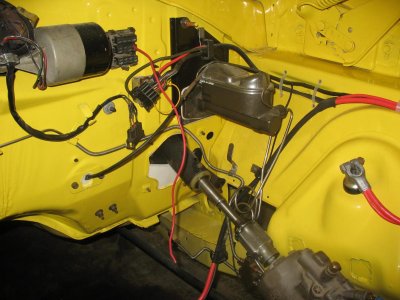

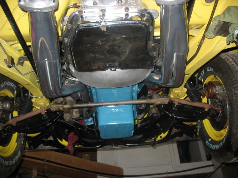

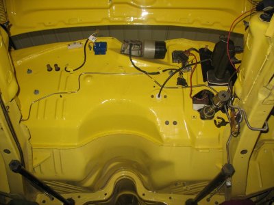

Does anyone have a pic of how the rear brake line routes where it transitions from the engine bay to the inside of the rocker panels?
I'm replacing mine and the routing of the current line doesn't look right...
Heres mine
