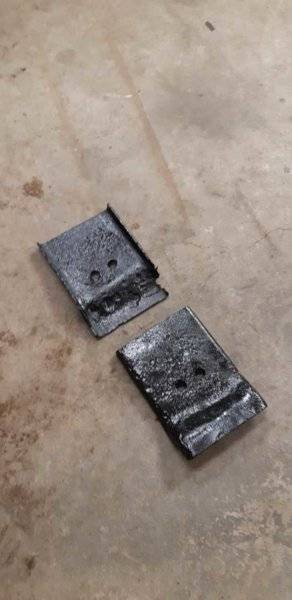

There are 2 plates, roughly 4" x 4", any idea where they go? I believe they were on the bumper itself under or on top of the bracket??

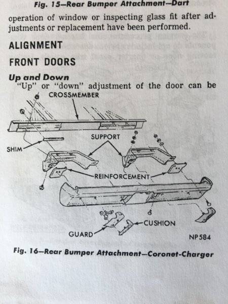

These?

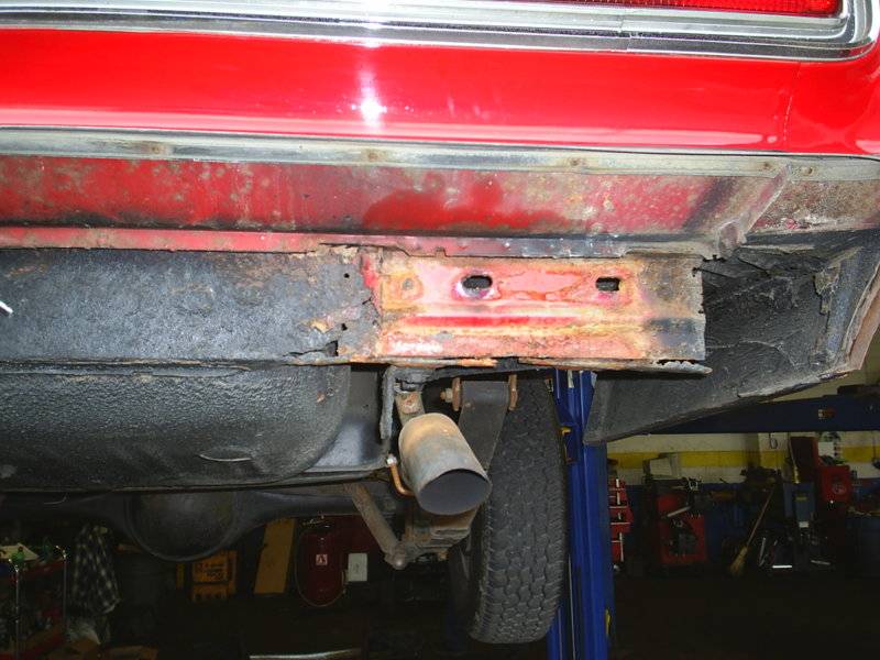

When I removed all the rotted area I never put them back on as they made the bumper stick out too far (on mine).
I'm pretty sure they go between the bumper and the bracket. I think they provide reinforcement for the bumper jack. It goes on the outermost position of the bracket.
Yes, between the bumper and the bracket with the bend towards the front of the car.
Thank you Charger Dana that is what I need!
These are the ones I couldn't figure out.
It's been so long ago that I reassembled the bumper, I don't even remember those. :thumbsup:
Thanks Dana.
