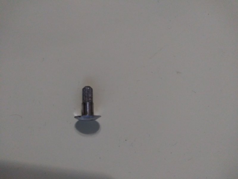

This is off a 66. Lousy picture, sorry. The full shank is approx. 7/16" and the splines are approx. 1/4". I don't have a mic so the diameter of the top part (smooth part) is approx. 5/32" and the spline a little smaller. Let me know if I can help more.

So does the splined part "lock" into part of the frame?

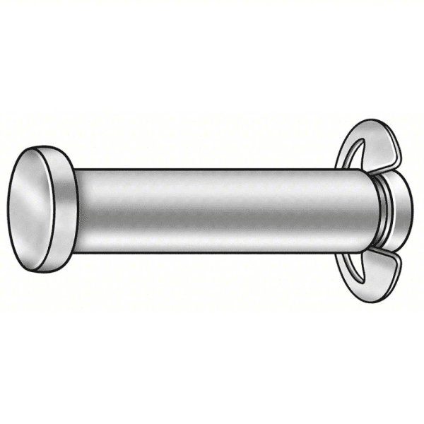

For those interested in another option, a small clevis pin may be it.
