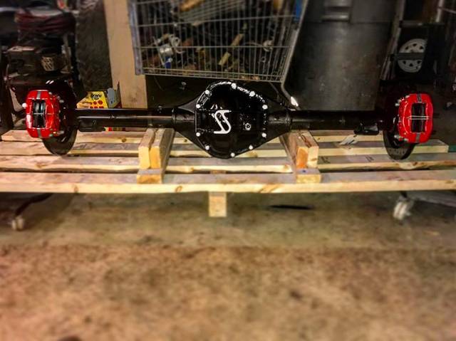

Getting ready to install the new S60 rear end complete with disc brakes into my '65 Coronet. This rear end has 3.23 gears, the S-trac differential, 35 spline axles and the Doctor Diff rear disc kit. Should have it in the Coronet and running in a few days.
Nice, identical to what I put in mine with the exception of wilwood brakes and 4.10 gears.
Sure wish Dr. Diff would get more of those 3.23’s made for the Dana 60 cause I could use a set.
Last time I talked to him, he was looking at December for the 3.23 gear sets.
Yes. Those are Ford Cobra calipers so they use the factory style e brake setup.
Agree because i also got them from Diff. I asked him about replacing pads in the future and he said 98 to 2004 cobra pads.

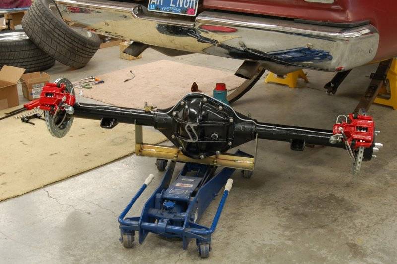

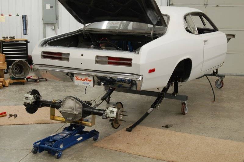

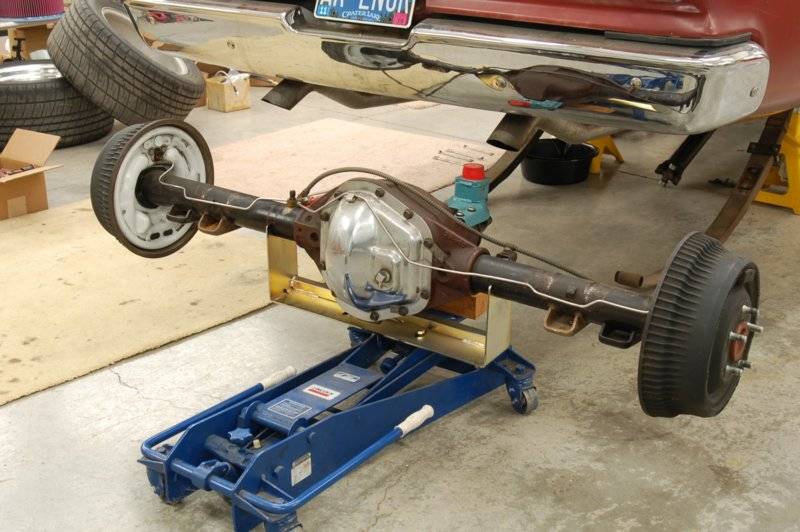

Pulled the old Dana out the other day and put the new S60 under the car. Still working on hooking up the new e brake setup plus a little bit of plumbing. Decided to build new shock mounts too while I was under there.
That is a transmission jack with a rear end adapter bolted on. That tranny jack used to just sit under the bench until I figured out one day that I could use it for a lot of stuff. I just had to build the correct adapters for it and now I use it all the time. It is the perfect tool for moving a heavy Dana 60 rear end around with since you can move it sideways. A floor jack is a lot more difficult to use and doesn't hold the rear end very securely.

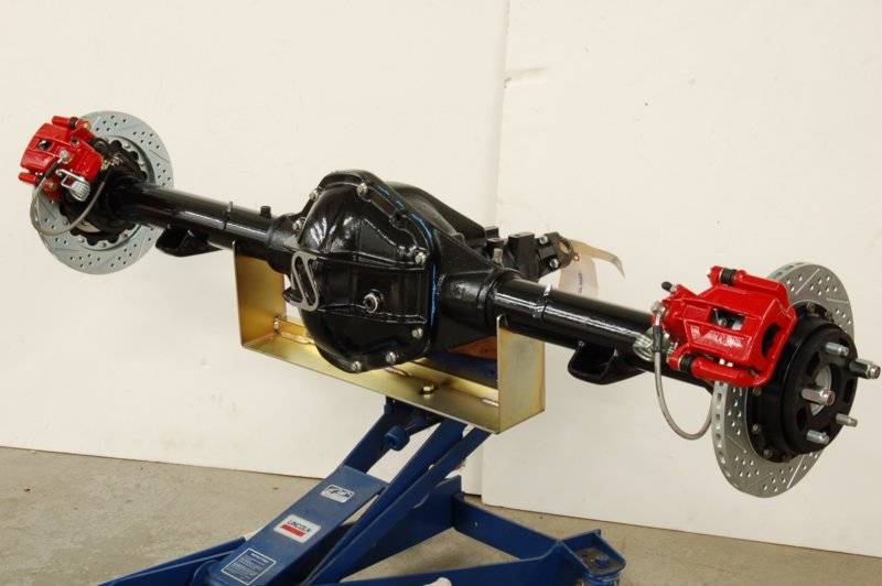

I've been driving the car for a few weeks and so far it is working just fine. The new 3.23 gears seem like a good match for the 5 speed transmission. The rear disc brakes require more pedal pressure so I'll probably swap in a master cylinder with a smaller bore size.
