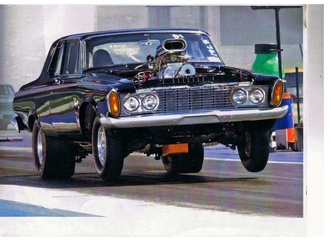

I used the SSBC fronts and stopping from a trap speed over 130mph is no longer a problem or in bumper to bumper.I will look into rear disc when stopping gets difficult again,maybe 150 or 160 mph:tongue8:There are several rear set ups that use the GM single puck Eldorado style caliper,they were junk on the new cars and doubt they are any better now:glasses6:
