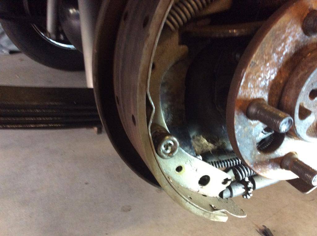

All in all I was pretty impressed with how well this last brake job lasted other than needing adjustment to take out the slack. I am going to replace everything just because I have never touched them since 2010 when I got the car lol. How do the pad look compared to new ones? do these have any life left? they look low.
They look quite new to me, so I would run them as is.
Like they all said!
Pull back the rubber seals on your wheel cylinders and check for wetness. If dry, you're good to go!
Spend your money elsewhere!

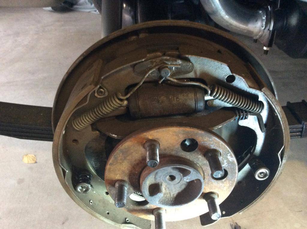

Did you fix the adjusters in place or did someone else do that? I don't like mine to self adjust either and had to do that with most of my wife's cars because she backs out of our 100+ foot long driveway doing 20 and nails the brakes right at the street making the rear brakes tight as a drum. Doesn't seen to bother her Durango but it would eat up the shoes on an 88 Shadow in short order until I did that lol. If you pull those shoes off, send them to me! :D
that's how a lot of the brakes were set up then, you had to manually adjust them.
I haven't even looked at the other side yet will today, the drum was real loose so much so that's what prompted this whole exercise, when I stepped on the brakes and then left off i could hear a creaking noise and a bit of a clunk. I virtually was able ti wiggle the drum back and forth a bit to pull it off. So I think it just needed adjustment rather than replacement.
Hoping the driver side is the same. All the parts expect new drums were under $100, BUT I noticed the parts are smaller diameter than whats there and the new wheel cylinders are made in china! the ones there say MADE IN USA! right on them so if anything they will just get a rebuild kit and not replaced. springs look good too nice and thick.

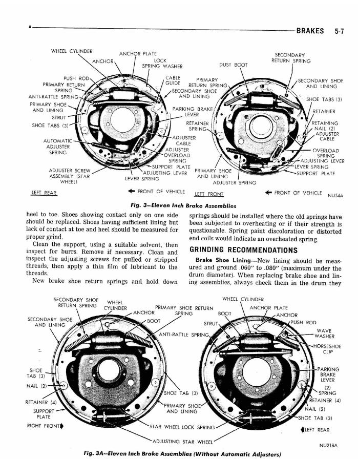

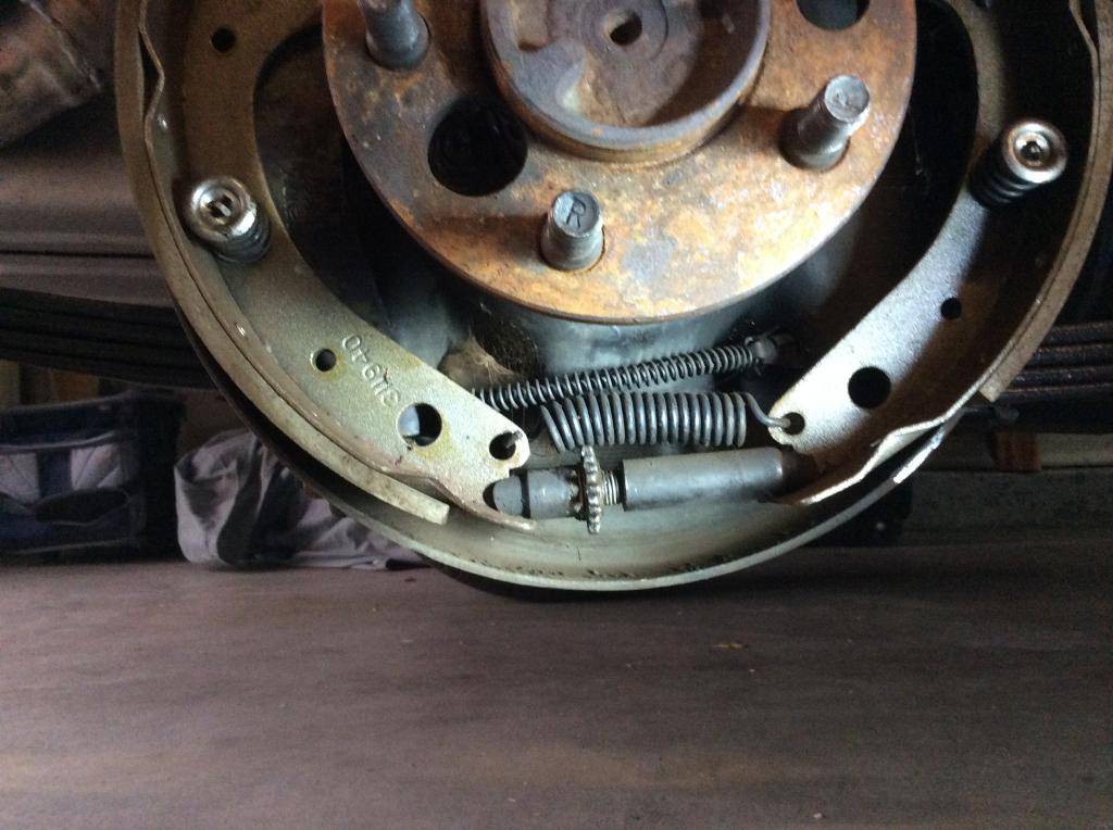

My first car was a 66 Belvedere and it came with the complete self adjuster setup and so did my sister's 65 Mustang. Not sure when self adjusting brakes became standard but self adjusting brakes showed up in this country in 1925 but I do know that they were pretty much the norm on cars of the 60's. Bigman's brakes are supposed to be self adjusting but someone removed the setup and just put a spring across the star wheel to keep it from moving on it's own.....which is also what I do to mine :)
What Bigman has there on those brakes ,is a manual adjuster and spring. Notice how coarse the teeth are on the adjuster wheel. Auto adjust wheels are finer teeth. Don't know if there still available or not but we use to sell manual adjust change over kits for guys that wanted to get rid of auto adjust. Sold many over 30 yrs LOL.
Ah, I see the difference in the star teeth....yeah. Just always used the same star wheel that came from the factory self adjust on my junk and never had a problem with them staying put. To tell you the truth, I didn't know you could get a star wheel with the course teeth. Learn something new all the time! :)

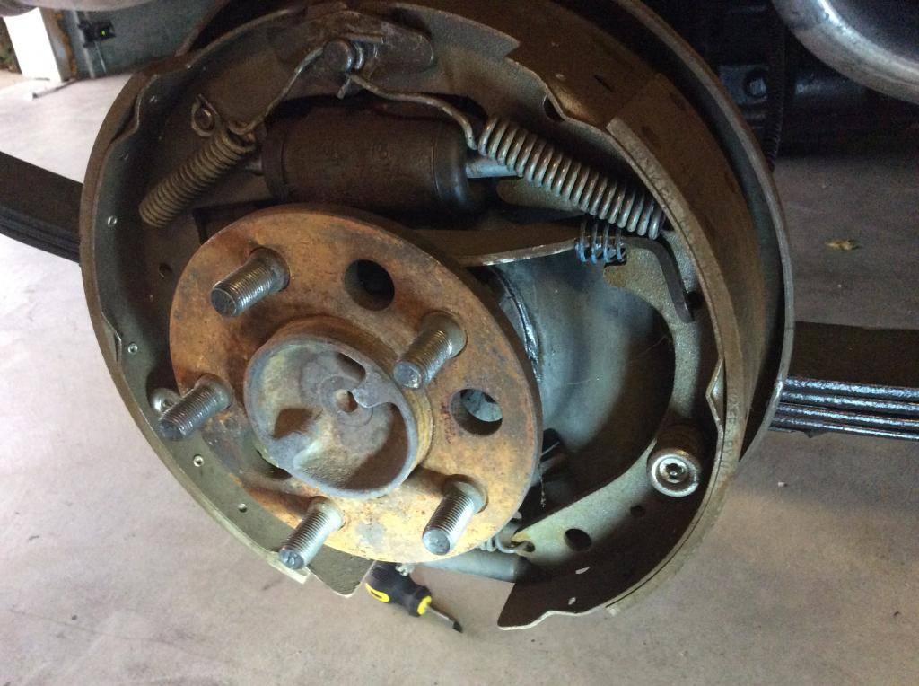

Drivers side - Was more loose than the passenger side. Also notice the studs "L" the last wheel I have left hand studs on lol one left! I sent all the parts back today after looking at these in good shape. Still need to test drive it in a few.
I'll be dogged....now I can REALLY impress my friends! LOL; thanks for the knowledge.
