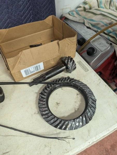

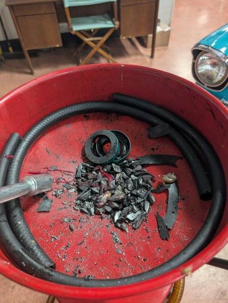

blew the rear end gears on my Charger because whoever set it up, did it terribly with mismatched parts, wrong thickness and pinion gear, etc. thing got so hot it was causing pressure in the gas tank and was pushing grease through the end seals before it actually let go...
got it rebuilt with 3.55 gears and now will be better all around... question is, y'all have a good break-in procedure?
when i went to 4.56 in my Ram truck, it was a couple of sessions of mind driving, 20-30 minutes a peice, let it cool completely after each time, change the gear oil after that and send it. is that what i need to do here?
carnage for those interested
