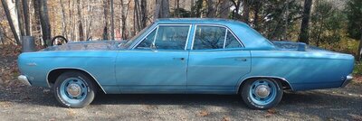

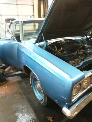

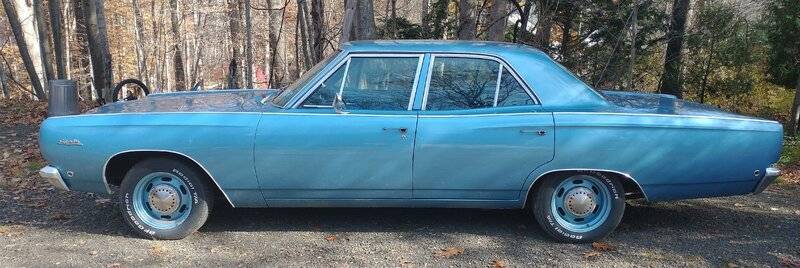

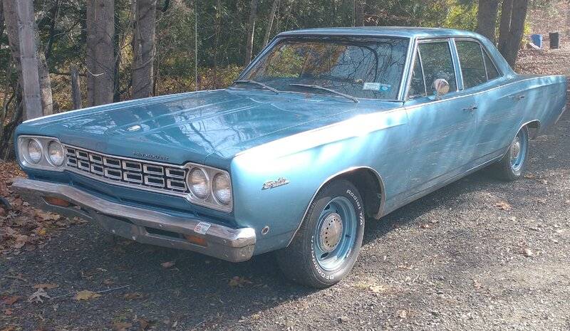

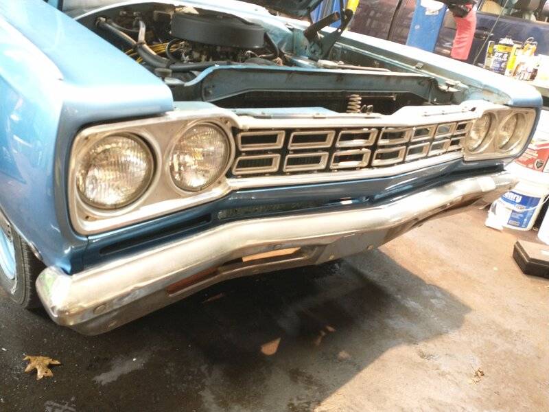

IMG_20211116_192947605.jpg View attachment 119732 IMG_20211120_120405988~2.jpg IMG_20211120_120419984~2.jpg IMG_20211120_120405988~2.jpg IMG_20211116_192937819.jpg IMG_20211120_120405988~2.jpg
Good looking car ! I like 4 doors. They can do everything a 2 door can and cost way less.
And it's not GREEN !
