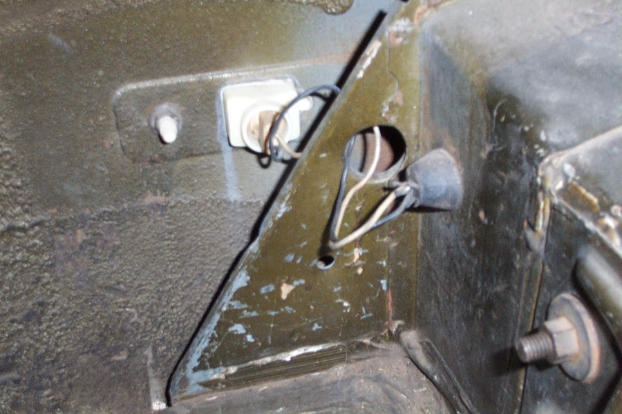

Acutally ther are 3 parts to the rear body harness. Main from dash to truck. Left harness which is part of the left tail light housing. Right harness thats part of the right housing. Here is a pic of the left side. The side marker leads are part of the housing harness, same for both sides. The housing harnesses are ran behind the bumper and the leads for the side markers come back into the truck via the rubber grommets.

Excellent! That's exactly the information I needed.
Thanks Moparmarks
