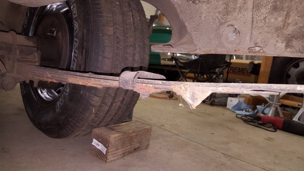

Can anyone tell me were I can get a rebuild kit for the rear leaf springs on my 63 belvedere. The front suspension is getting a complete rebuild and figured since the rear springs look a little rough I'd clean them up and rebuild them also but not having any luck finding anything. It doesn't need to be OEM, it just needs to fit.

Well Mopar SS springs should fit. Also try Eaton Spring. Or ESPO springs.
Mancini carries kits for 67 and up. The difference may be minimal but might be worth a call.
http://www.manciniracing.com/lespreki.html
However, once you get the rebuild kit, plus front and rear bushings and the time involved, a new set may well be a better deal. New set comes with the front bushing installed. Depending where you shop, s.s. springs for $120 each plus free shipping. I got mine from Summit.
'64 & earlier use the 20" front segment. '65 used a 21" front segment, '66 & later used a 22" front segment, B bodies & E bodies have different rear segment lengths.
As stated, I haven't seen a "rebuilt" kit for them. ESPO or Spring N Things will set you up
Thanks for all the useful information, looks like I'll be measuring my springs and start looking for new.
For the price the SS springs are a steal & should fit yours with no added expense. Just have to buy the right weight spring- 3400 or 3600#springs.

I'm having trouble finding s.s. springs, do you have a web address?
