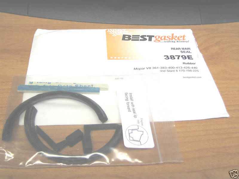

Hey guys I'm looking at replacing my rear main seal, but I've had one of the Mancini Racing kits with the cnc machined retaining block on backorder for over 2 months now and at this point just want to cancel my order and use a generic seal with the stock retaining block.
The problem is, I was told if I get the generic seals that the kit should also come with two straight pieces of rubber to seal each outer side of the retaining block (total 4 piece kit). But every one I'm seeing has the two half circle seals and two "L" shaped right-angle seals like the attached picture. Is this correct or does anyone have a suggestion on a kit to use?
I was told the new kits just tell you to fill the outer edges with silicone which I figure would eventually leak, so that's what I'm trying to avoid. Thanks ahead of time :headbang:

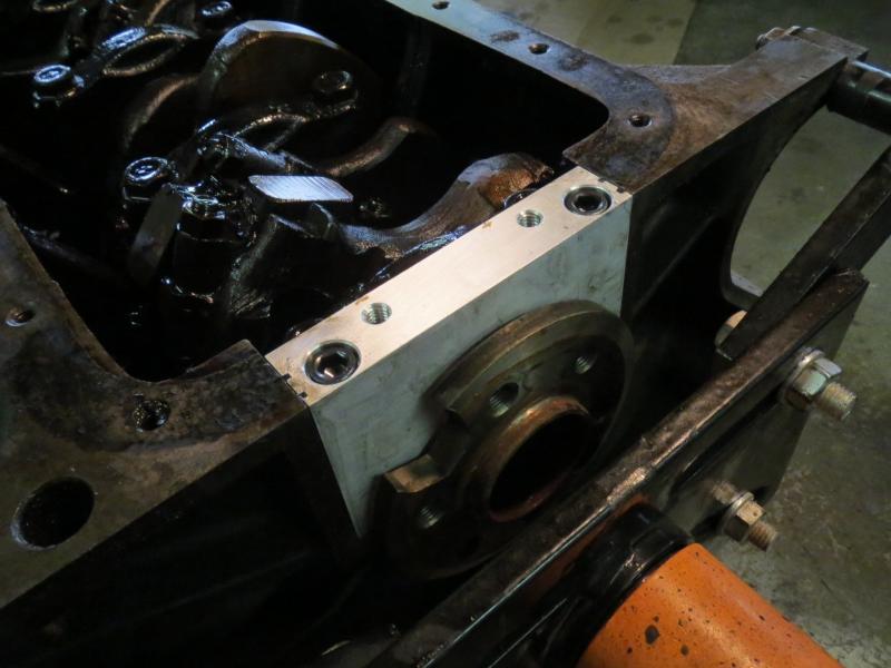

I had a rear main leak on my blue Road Runner after the motor was rebuilt. I took it apart and put new stock style seals in it 4 times before trying the new kit. That took care of the problem for good, so the billet style is all I'm going to use in the future.
I just walked into Mancinis last week and bought one the billet ones, back order?

I went with the Viton rear seal and Silicone side strips from 440 source on the stroker. Ended up using the factory cap with them, don't leak a drop.
