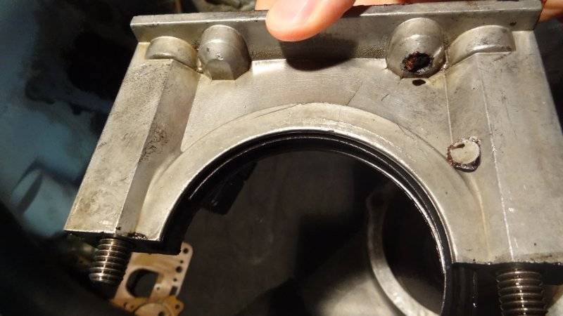

Hi all!
I think I already know the answer, but it doesn´t hurt to ask. would you change this main seal retainer?
it has a crack, and as you can see in the pic, the bottom from one of the oil pan bolts came off.

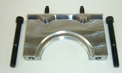

which one do you recommend to buy?
hughes: https://hughesengines.com/Index/pro...h&search=rear+main+seal+retainer&partid=27110
mancini: Mancini Racing Billet Rear Main Seal Retainer
or whatever you know works, and preferentially cheaper than the two links I posted.

Put Teflon sealer on the bolt or stud. No big deal.
Doug
That crack is bad. Didn't see it in the original picture. Time for another piece. I still like the factory part better than the aftermarket one.
Doug
Definitely would change that when it is still out. PIA when it is installed in the car.
