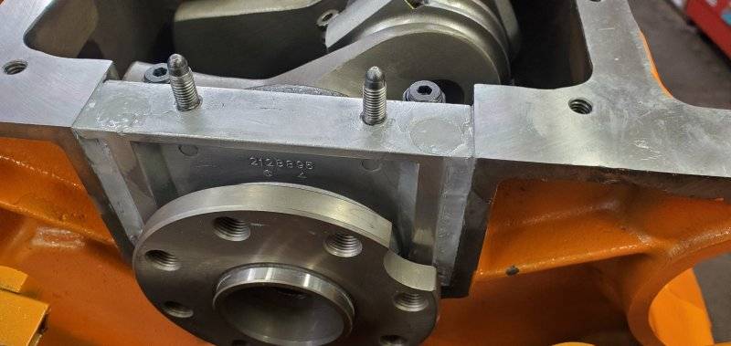

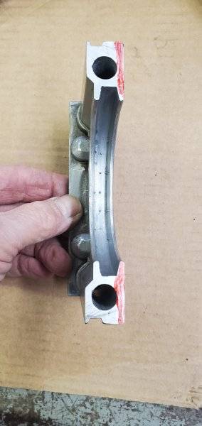

I never use them. A small mount of anerobic sealer on the cap. Ultra Grey on the sides . Fill the cap bolt holes. Not all pans cover these holes completely. Motor never leaks a drop. Been building big blocks like this for years.

Fill the cavities in the seal housing with sil to slightly above the surface.
Leave to cure.
Trim the excess when cured.
Install housing with sil down the sides & base.

Did you read my post ? I'm as nuts as anyone about leaks. My engines are waxed.

I didn't initially associate the smallish red streaks for the anerobic sealer....Is it possible Chrysler for some reason, intended Not to use Any sealant there & wouldn't std engineering practice have been to use a full perimeter paper gasket between block & retainer, totally surrounding the Retainer bolts at the retainer to block joining point ?
Don't worry about what chrysler did 50 yrs ago.
I use ultra black in these areas myself.
All the suggestions here are good.
Thx for all responses & DVW very informative photos..... That's absolute functional Perfection !! Don't know why the Oem Side Stick Seals are so Unappreciated,. The Oem Side Stick pieces have always (for me) Controlled Expanded properly, done their assigned Engineered function & sealed perfectly with the Least later cleanup mess effort & Didn't seem to need any modification alterations there....I think I have a better understanding of how the Rear Seal assembly works now...
