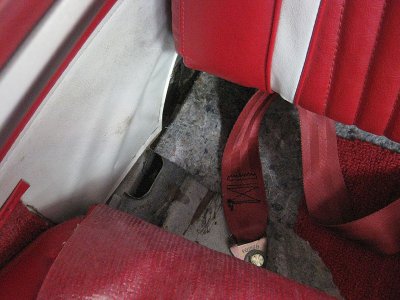

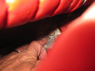

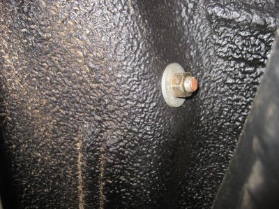

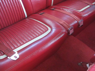

Here are my belts. It was cool when my kids were little.... I had two baby seats buckled in the back seat.

Right on. Almost looks like the centre ones are close to where the trans hump would be at the bottom of the brace. I have a 5 and a 7 year old who have suddenly decided they want to go cruising with me which is pretty cool. I have new belts and a hardware kit. Thanks for the pics.
