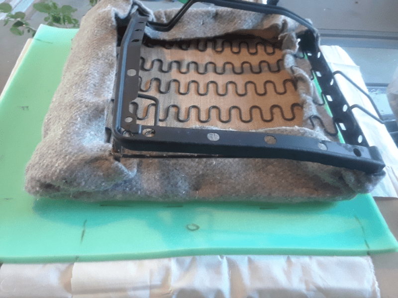

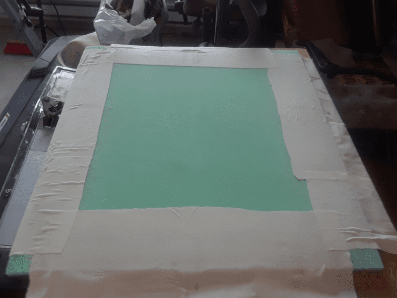

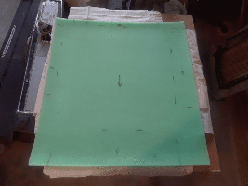

I used the burlap then covered it with heavy felt. Attached dense upholstery foam 0.5 or 1 inch depending on what you want (muslin glued to the sides) and then covered it with the colored upholstery. As for the backs I was able to reuse the existing padding. Otherwise, I would have done the same. My process I made into a document and is posted on another website. Also, I came up with my own method for attaching the backrest upholstery since those tabs are not always the best to reuse.
Here are some pictures:
