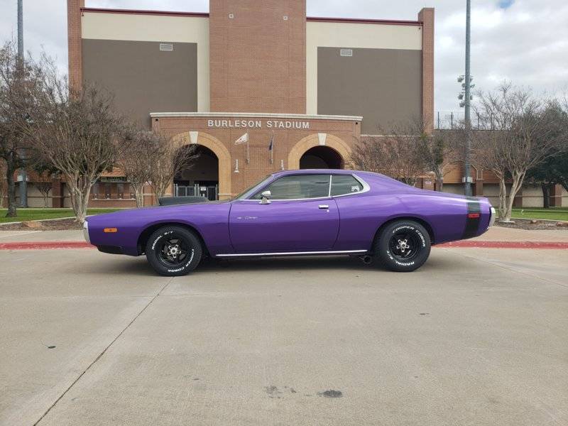

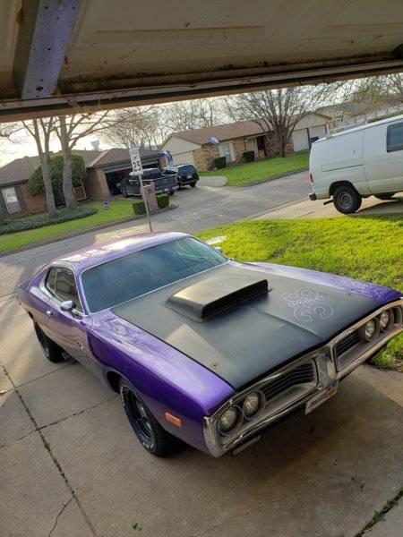

I recently added Mopar xhd rear springs in my 73 dodge charger. Will a factory shock be OK or do I need a longer shock from a different vehicle so it don't pull the body to the springs? I want to stiffen the rear up a little as well. View attachment 914085 View attachment 914087

I was told it might be smart to run a c body rear as it will. Also help raise rear an 1".

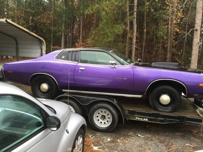

you could of ordered springs from Espo with plus 2 inch to raise the back end.
Running the same size tire on the Bee with stock springs ,do you just like the rearend up higher?
I just like a little rake, but I need new rear shocks and just wanted to make sure I didn't need any longer because the xhd springs are stiffer and have more leafs
