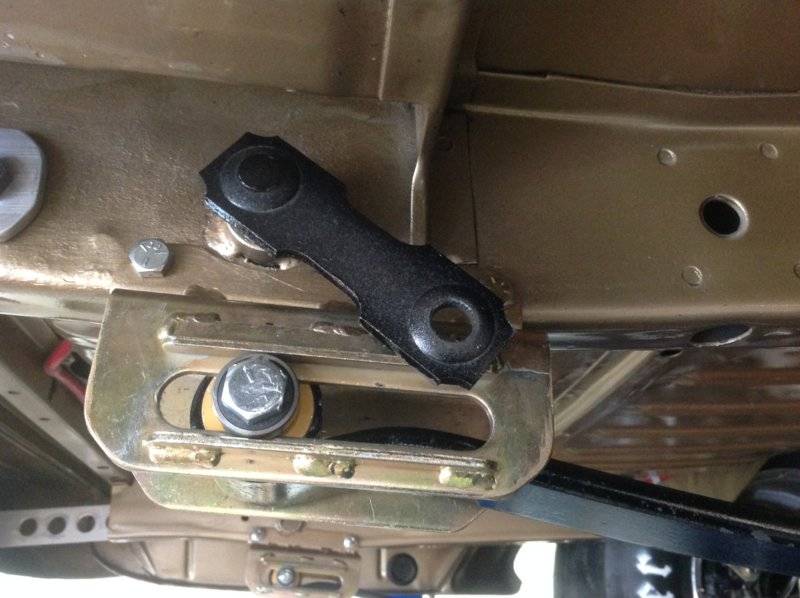

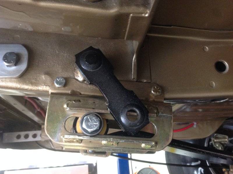

Here's a couple of pictures to give you an idea of the swing verses slide.
You can see how the shackle starts it upward swing as the slider will continue to travel forward.
Here you can see that the shackle has gone past it's maximum travel and would be pulling the leaf back at this point. Your shocks need to be long enough so that they allow the leafs to go into their full arch.
