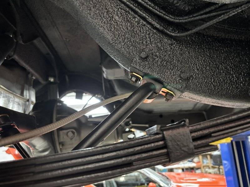

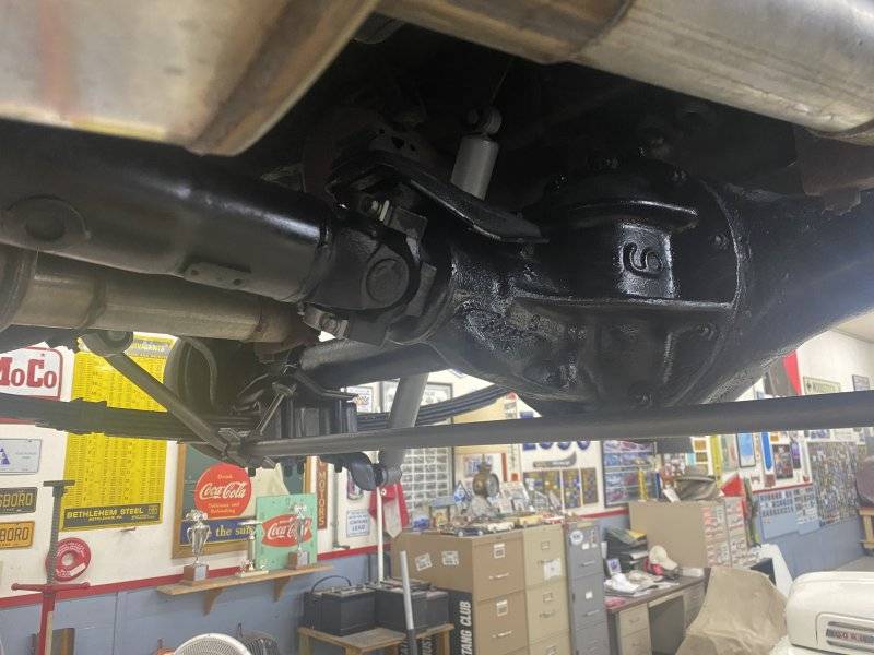

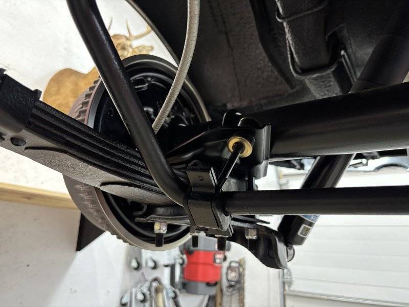

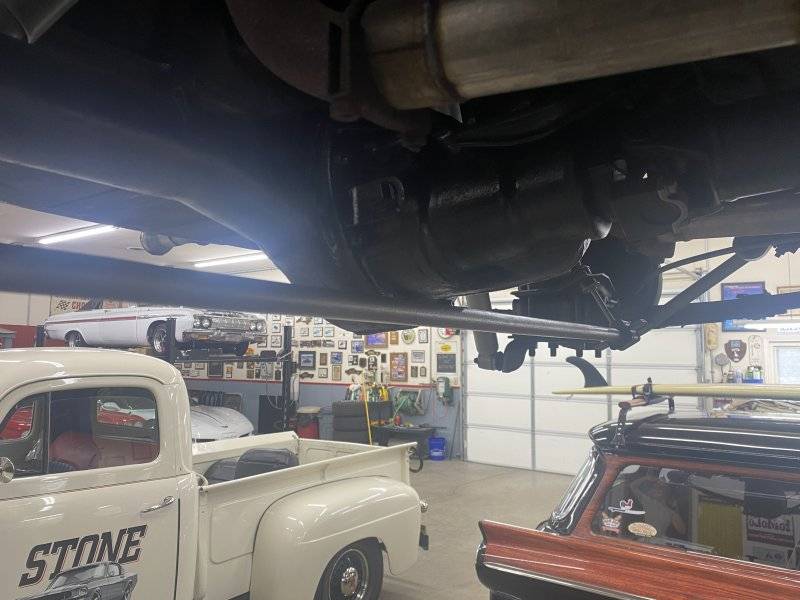

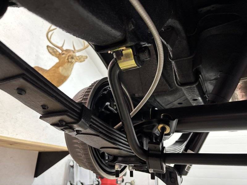

Pics of the parts mentioned above installed.
