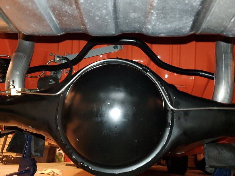

I can buy a later B body rear sway bar but the frame rail mount looks different. I searched old threads and didn't find any info.
I plan on welding a washer in the large hole for the locating pin and redrilling the u bolt holes.

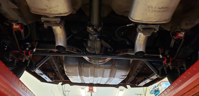

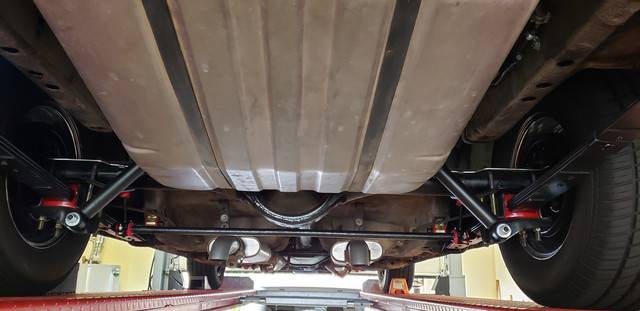

Are you putting a sway bar on a car that did not come with a factory rear sway bar? I could not find replacement bushings for my 73 rear bar when I rebuilt the suspension a couple years ago. This is what I did using generic Poly bushings, pics below.

I would think the mount in the top picture would need threaded inserts to attach it properly. You could weld in something.
Can't really tell by the angle, but is the "vertical" part of the bar the same length?
Could pic 2 be "just" missing the part of bracket that bolts to the frame rail?

Thanks for the replies everyone. Looks as if it's missing vital parts from reading your replies. I think I'll pass on it.
At $40, I'd pick it up & play with it. Any of the components could be modified to make it work. Its N/A in 71 so I assume originality isn't an issue. Any bar mounted geometrically correct will be better than no bar. If you want to add a cheap bar, the link at the bottom is the lowest cost option. Its what I have on my 71.

I mounted an aftermarket rear bar to my 1967 Coronet, of the same style. You can locate the frame brackets where they need to go, and Mark the location through the bolt holes. Still a smaller hole where marked in the frame rails. Using a tapered punch, drive some of the frame material into the hole, and attach the brackets with self-tapping bolts. This has worked for me; bar has been on car for about 25 years.
On another note, I discovered years ago that '80's Police Diplomats had a rear sway bar that was the right width for our old B-bodies. I just had to modify the frame brackets for our wider frame rails.
