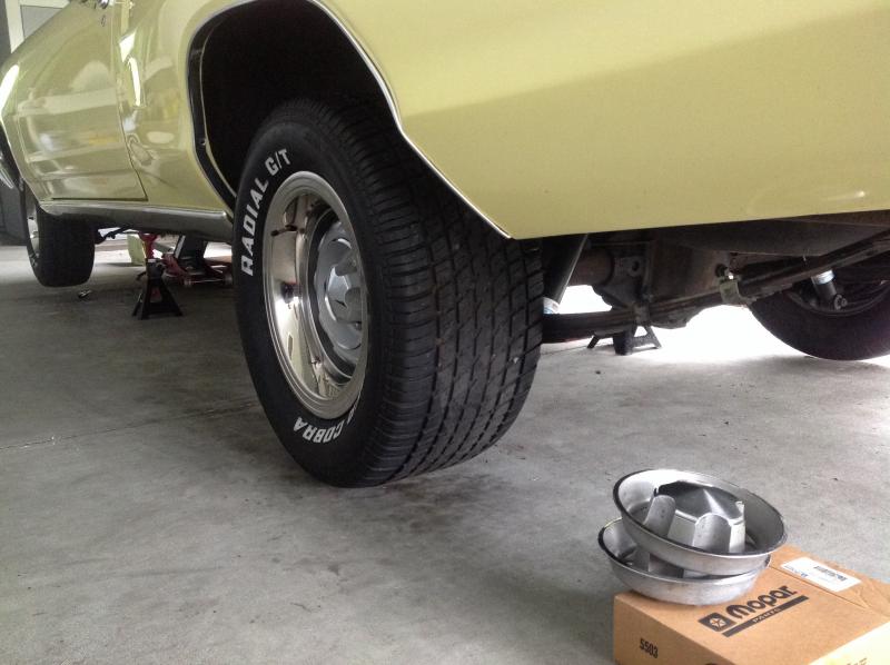

image.jpg. 295 50 15. 8 inch rim. 69 Coronet R/T. Mounted and balanced from Summit. A hint of scrub inside wall on leaf, only when taking a lap at Willow Springs pushing hard in a turn. Normal driving no rub.

View attachment 275380. 295 50 15. 8 inch rim. 69 Coronet R/T. Mounted and balanced from Summit. A hint of scrub inside wall on leaf, only when taking a lap at Willow Springs pushing hard in a turn. Normal driving no rub.
Dennis, what backspacing are those rims?
thanks!
thanks!
2.75" per the Summit website. I did not pay attention when ordering. Just got the 15x8 Rallyes. You should see the parking lot stripes!
Thank You
Im surprised you have clearance with only that much backspacing? Who'd a thought...
Those must leave a mean stripe! I like the tread much better than the BFG's too. Looking forward to re-skinning my Bee.
thanks
Thank You
thanks
Yep.... Dennis helped me on mine. On the 68 i have 1/2 clear. I saw his and knew right away that was the look I was going after.
