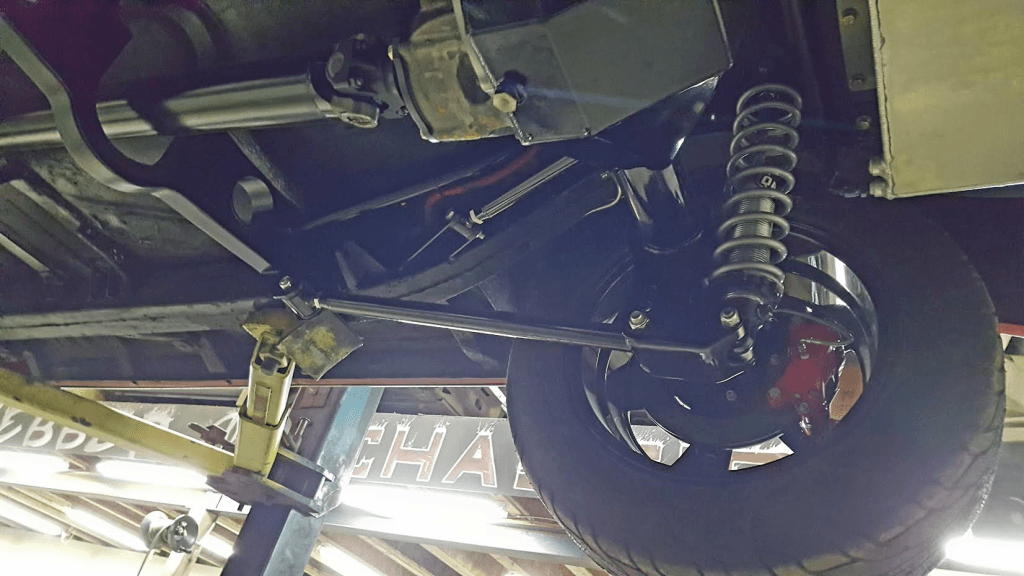

I went with a 4 link set up from Reilly motor sport, my cars not in the road yet but a couple other guys here are running it and very happy with it. Comes with double adjustable Viking coilovers for the rear
https://reillymotorsports.com/store2/street-lynx-66-67-b-body.html

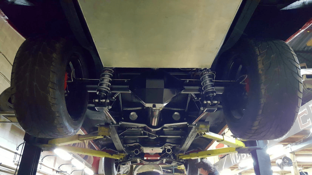

I'm having a custom triangulated 4 link done very similar to the one shown under this car done by my buddy

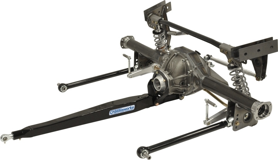

I've used a couple of Chris Alston Chassisworks kits,
made them work, used Ladders & 4 links, double adjustable,
a bit pricey but nice set-ups quality spherical heim-joints etc.
a good read/explanation of how stuff sort of works
http://www.cachassisworks.com/stories/techcac-003_web.pdf

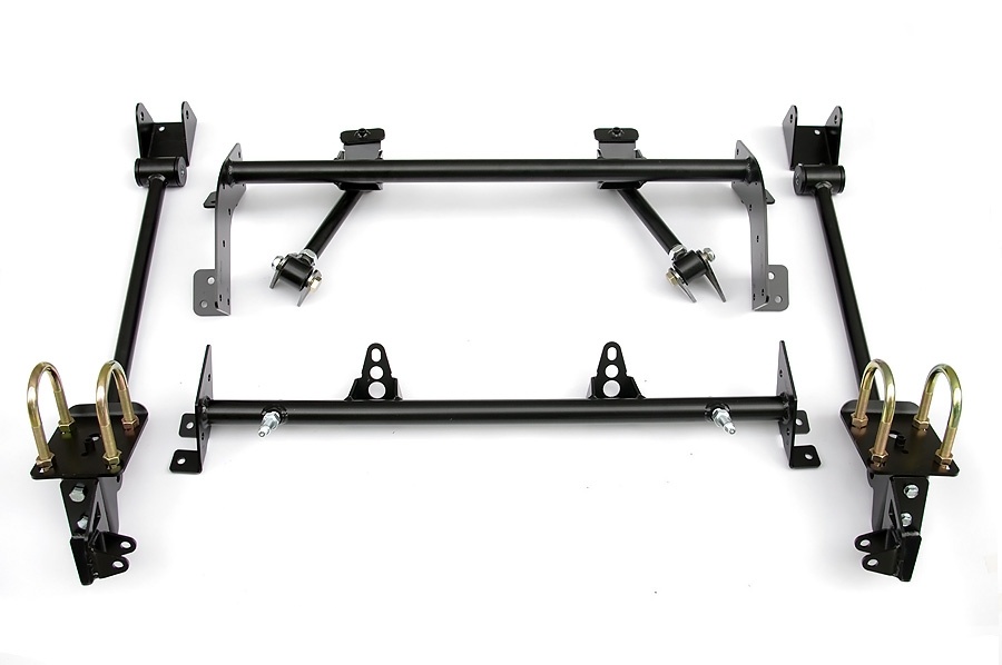

Chris Alston Chassisworks Basis 4-link with poly street bushings kit {Cheap}
they don't make anything Mopar or B-body specific

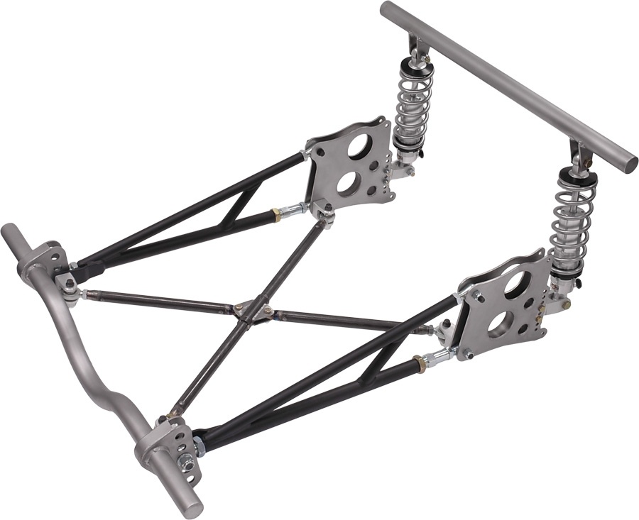

RJ Racecars/Quarter-max {Rickey Jones of NHRA Elite team P/S fame}
has some nice pieces too...

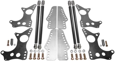

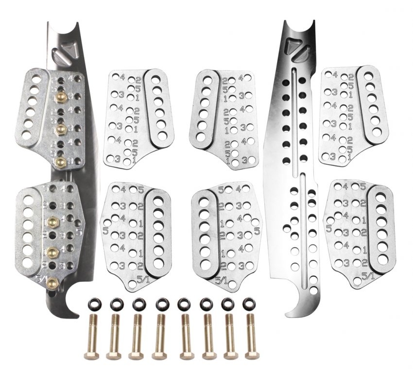

Extreme Adj. Billet 4 link billet chassis brackets/mounts $2400
Racecar professional fabrication pieces
{I don't think they make anything that's Mopar or B-Body specific}
RJ/Quarter-max Basic kits like $290, they have another better kit, for like $1600

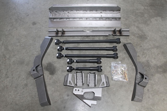

There's a bolt-on 4 link deal from Ride-tech,
like $1400 specifically for B-body kit,
good up-to about 500-600hp at the rear wheels,
if you beef/gusset up all the org. axle & spring mounts,
torque boxes everywhere etc.
you can use coil-over's or airwave/bags
A few Pro-touring guys have ran them & have loved them
good ride height & ride quality

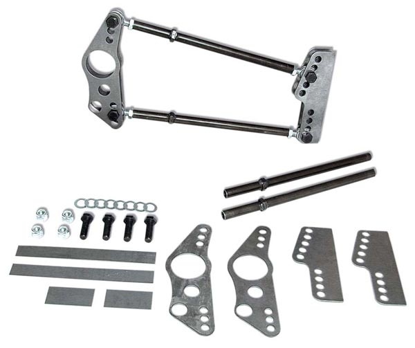

Competition Engineering has some decent inexpensive stuff too
4-link kit for like $240, check out their website,
they have a lot of universal you fab stuff
