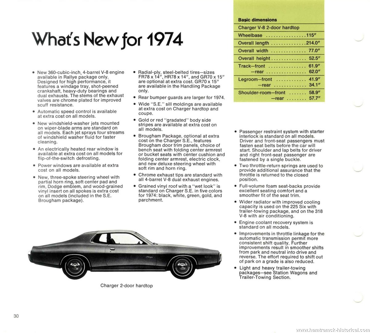

I should have been more specific with this statement. The original post asked about 74 Charger with dual exhaust. So did a 74 Charger with dual exhaust come with either turn downs or Flame throwers optional in California? My understanding was no Flame thrower tips in California. Obviously with the plain valance on his car, it had turn downs originally.
1974 Dodge Charger
Chrome exhaust tips (Machine Gun Tips) where STANDARD on all 4 Barrel V8 Dual Exhaust systems
However in CA you couldn’t get the 400 4 Barrel Single Exhaust or 400 4 Barrel Dual Exhaust High Performance engine
Enjoy - Click on links
http://www.hamtramck-historical.com/images/dealerships/DealershipDataBook/1974/74_Charger (1).jpg
http://www.hamtramck-historical.com/dealerships/1974DealershipDataBook-03.shtml
http://www.hamtramck-historical.com/dealerships/1974DealershipDataBook-01.shtml
http://www.hamtramck-historical.com/vintageAdvertising/1974DodgeChargerBrochure-01.shtml
Still could get a 360 E58 or the 440 E86 with dual exhaust and tips...
Can't go with you on that. I know someone with a 74, 400 that had HP and dual from factory. Had to be ordered though.
Besides, the Hamtramck info only says 225 not available in CA.
Thank you for all the information. Great to know the options. My car is going back together with the tips and valance cutouts.
