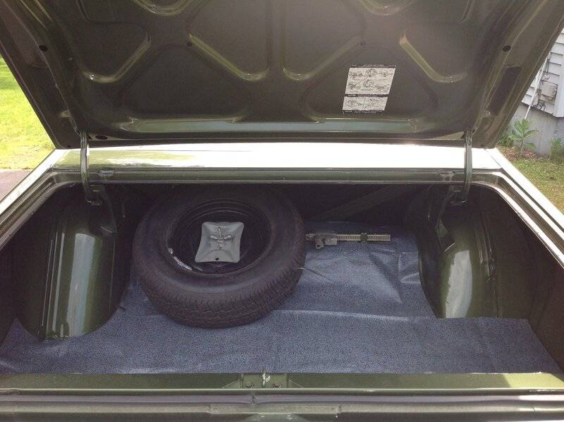

does any know why the wheel wells in a 72 satellite/rr are different from left to right ?
(see attached pic)
I am lost as to why they are not both the same.

I think they are like that for all the b-bodies (except maybe wagons) from 1971 to 1978. Like you I don't know why.
The evap can is located in the left wheel well behind the tire in 71 to early 72. It was larger to accommodate this. They just carried it through 74 since the tooling was already done.
The rumor has always been that it was done that way for NASCRAP, can't confirm.

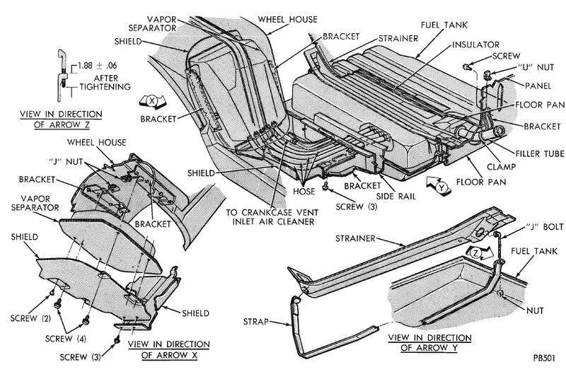

As posted, the extra room was for the E.C.S. fuel tank vapor separator/expansion tank as originally designed for ’71. As of April 1, 1972, a design change went to production, new fuel tank, filler neck, and a smaller vapor separator located forward of the fuel tank. Re-tooling would have required new wheel well half’s, trunk floor, left trunk floor extension.

Wow, What an over-engineered looking (and costly) setup this appears to be. Would I be correct in that the final iteration resulted in the plastic charcoal cannister being adopted for the collection gasoline vapors?
Beginning with all ‘72 production, all evaporative vapors were collected in a one year only two-stage purge (4-nipple) charcoal canister. Dedicated carburetor canister purge ports didn’t come until ’73, 3-nipple canister.

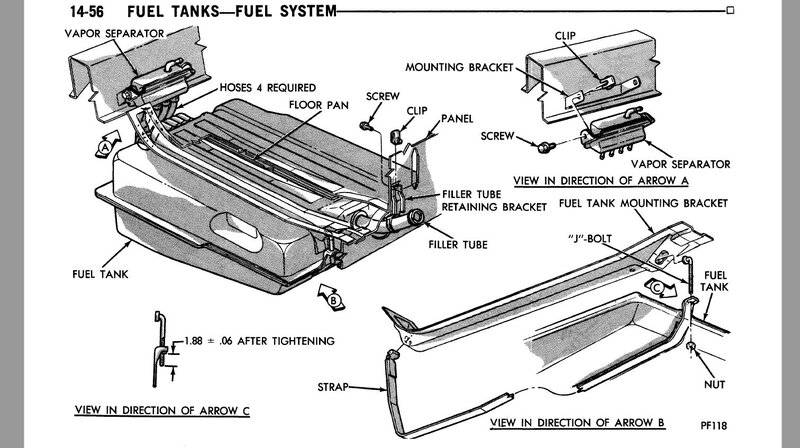

April 1, 1972 and up design;
