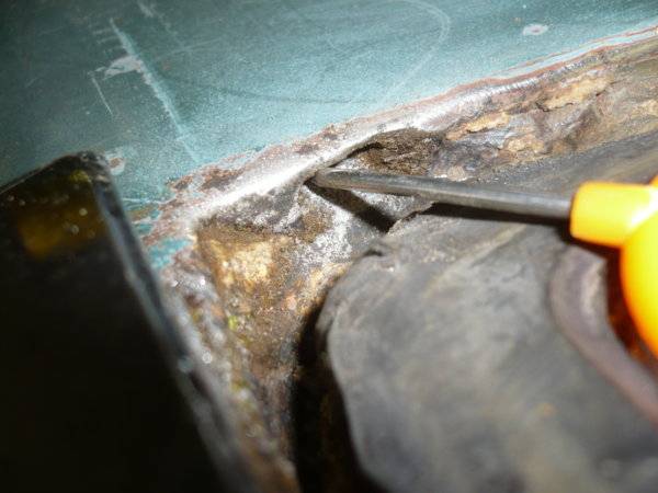

Got the trim off and after scraping and cleaning out rust in the lower corners, I have a small hole in the drivers side. I will post pics in the restoration forum.
I had holes in all 4 corners wasnt to big of a pain to fix just make sure you get all the rust out and check the underside my biggest rust spots on my 66 was the window corners the ends of the drip rails and the outer sail panel trim took a bit of work but i got it all fixed
Just ran water along the bottom of the rear window and discovered a leak in the passenger side lower corner. I taped off both sides and blasted the area with glass beads to remove the rust and clean the area. You can see where the problem is and not too hard to fix.
