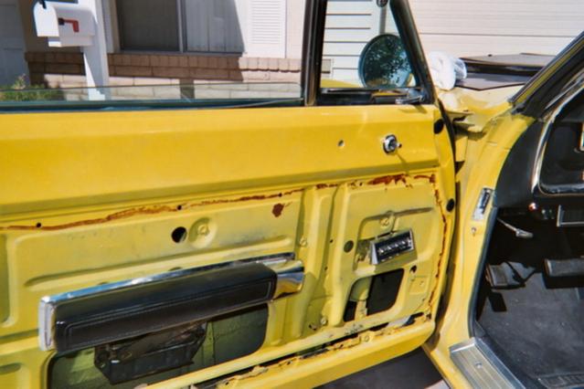

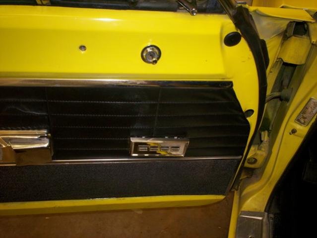

If you think your manual windows are a bitch to find parts for and to work on, come look at the friggen POWER windows in my 66 Coronet! I don't know what I was thinking when I thought it would be cool to have an old muscle car with power windows! :(:Groaner: After the holiday's, I'm going to have to try and remove all of the PW system parts out of the car to restore them all and replace LOTS of the parts and pieces and I'm NOT looking forward to it! :no::Groaner:
