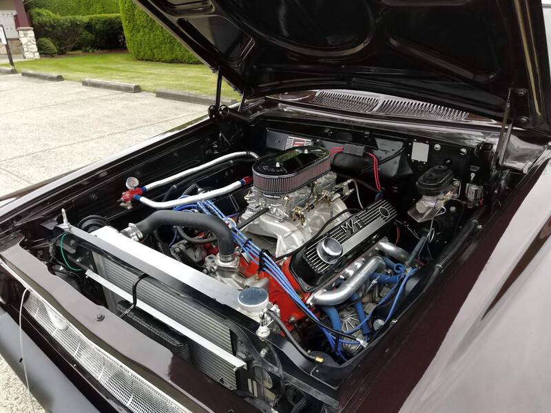

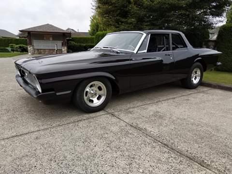

Gorgeous car by the way. :thumbsup:
(Geez, lookit that fuel line!)

493Mike, the car still has the stock hood latch, it's just hard to see.
Ahh! I am used to later, early Bs. Still looks clean.

That's a great looking '62 you have there :thumbsup:
