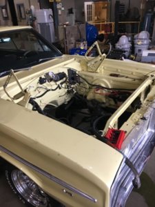

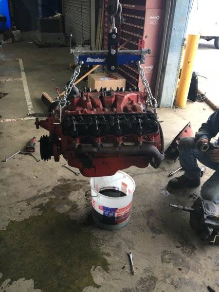

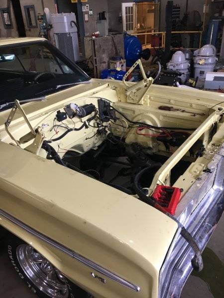

Pulled motor out of my 66 coronet yestrerday.Motor ran ok just smoking bad.I have found a weiand 7503 intake for it and plan to add 4 bbl.Anyone have any advice on rebuild
Thanks
