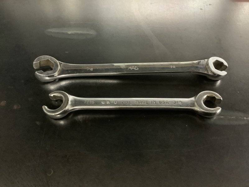

I also recommend purchasing the correct size flare nut wrench to avoid rounding the flare nuts in the future. You can get singles at the parts store and they are reasonably inexpensive. It might save you some misery next time you work on the brake system…

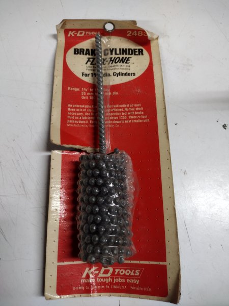

Not to hijack my own thread, but a friend of mine bought this at at yard sale for $1. He gave it to me for this job. Since I don't need it I'll give it back.
