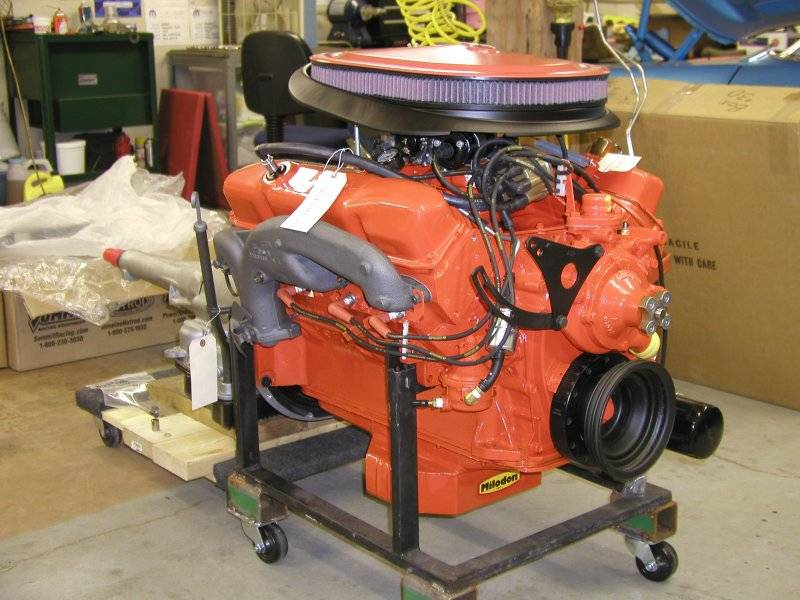

Of course I spent a bit more than what you have budgeted for your engine and that was 11 years ago when prices were cheaper than today, so keep that in mind. Regardless, I say build that 400 matching numbers engine and run it like you stole it!
My finished engine before and after installation in the car.
