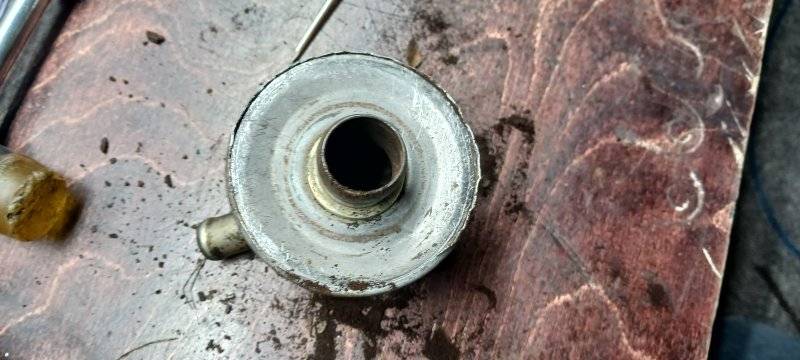

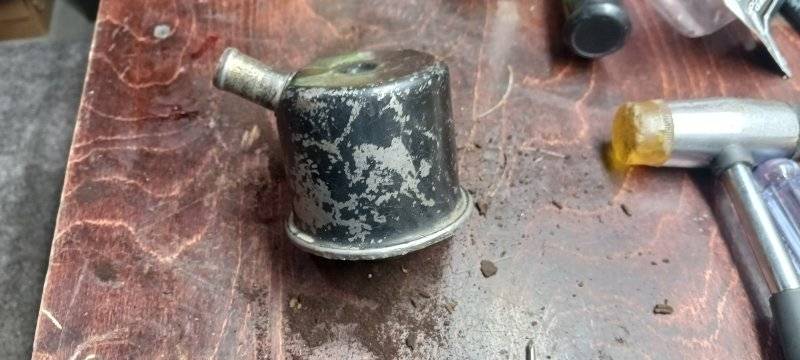

So, I have this breather with one one nipple on it that I'd like to use. I have a six barrel with a vent on the center float bowl. I think it should be fine to T a hose from there to the hose that goes from the breather to the air filter base. I have the breather all apart and here is what I got.

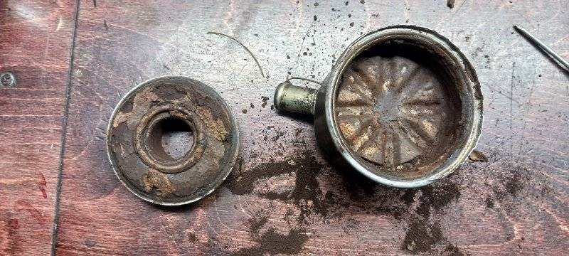

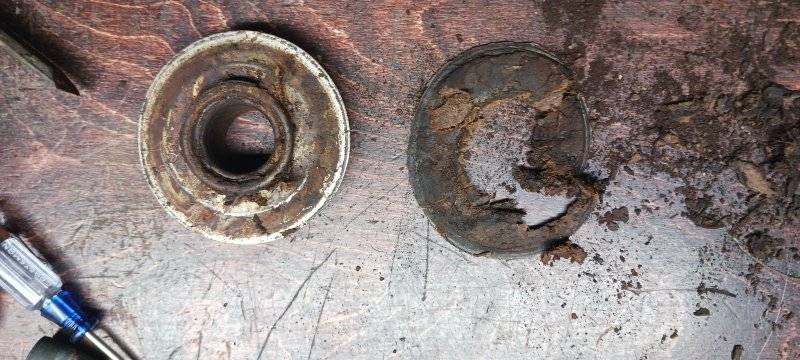

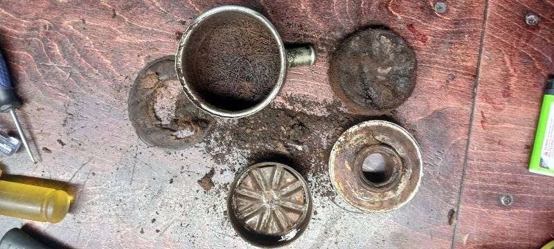

After a little work with a hammer and chisel it comes apart. It looks like, I'll just call it cardboard, is right above the bottom metal plate (the doughnut shaped part). Then there is a wad of something that resembles scotch brite pads, a metal baffle, then what looks like to me, a big pile of compressed dog hair. Then, another metal baffle that I'm not taking out. I've read to replace this **** with brass wool. Any tips? Or, I could buy a new one for $80.

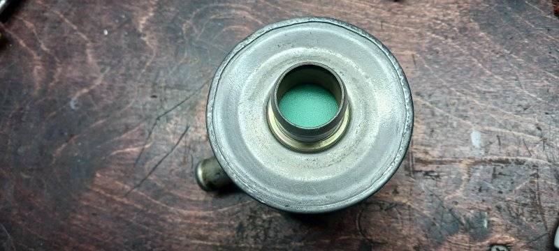

Horse hair was used.
I used some white breather material from local parts store to replace it.
Then I used a very thin layer of silicone along the outer edge of bottom plate before I crimped it back together.
Works great and doesn't leak a drop.

So, I wasn't to far off calling it dog hair! Thanks!
