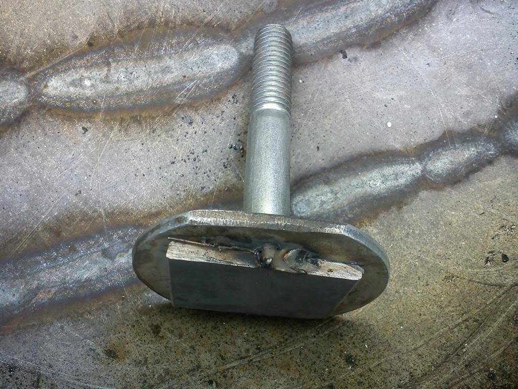

to press out that busing i made this with a bolt, washer and piece of steel, pressed them out with a vise in like 10 sec
