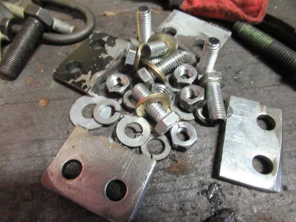

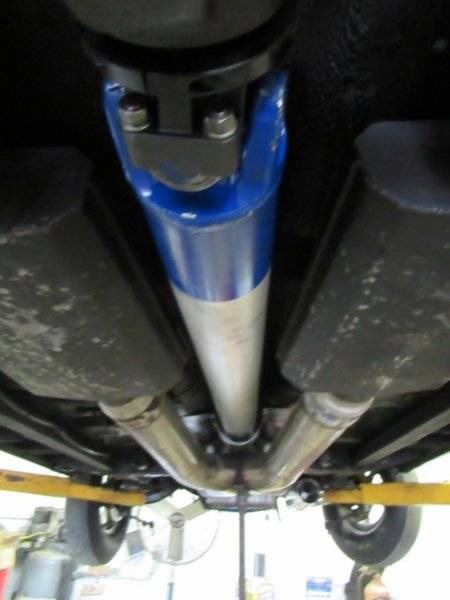

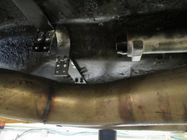

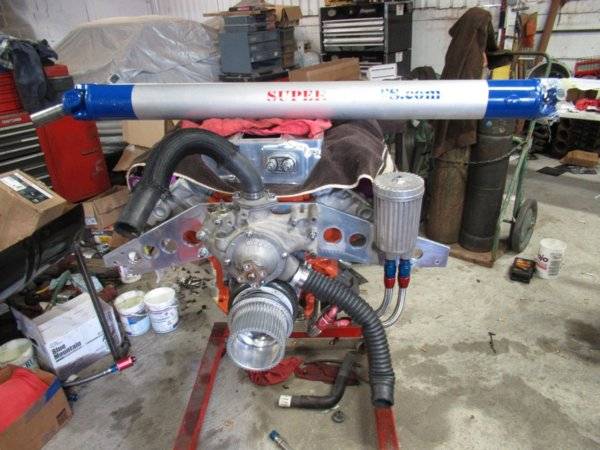

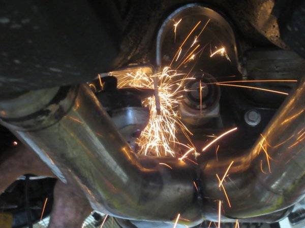

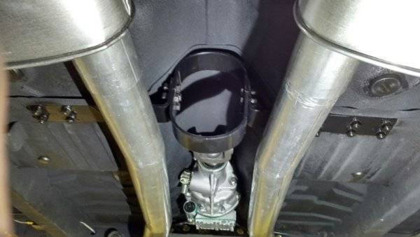

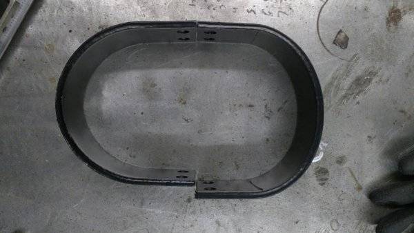

I had the Lakewood universal loop.When I upgraded to an aluminum shaft,it did not fit the loop.After some slicin & dicin,then welded it together,I saved some weight with the hardware and reshape of the loop.
8.23.17 010.jpg 7.31.17 017.jpg 8.23.17 009.jpg 8.23.17 014.jpg 8.23.17 015.jpg 8.23.17 017 - Copy.jpg 8.23.17 019 - Copy.jpg 8.23.17 020.jpg 8.23.17 021.jpg 8.23.17 022.jpg

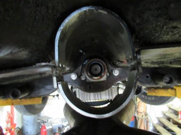

I bought the cheap generic jegs loop 30$ I think. Had to do a little tweaking but rock solid once installed.

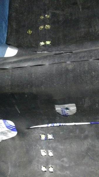

I went back and read your posts and looked at the pix. How did you keep that from making a lump in the carpet? Also I will have to look at my 70 Roadrunner and see if I have a "double" floor pan overlap in a good spot.
I got the moroso line lock from summit, go to suggested parts and there’s a brake line kit you can get with it

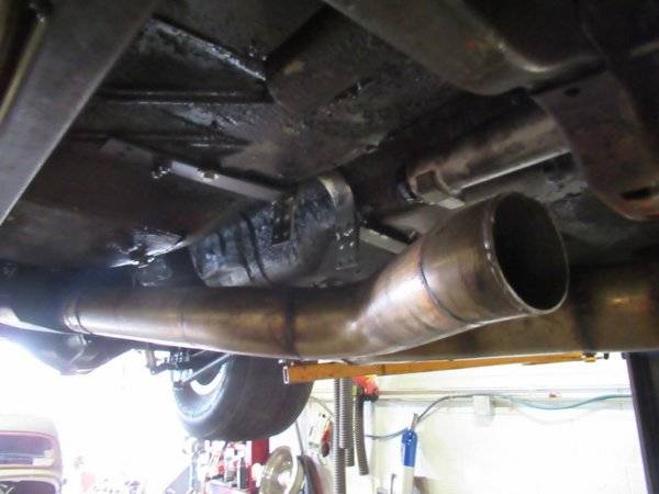

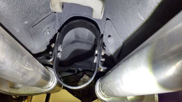

I have a gear vendor overdrive so my loop is a little farther back. I had sound deadener so I cut holes in it for the bolt heads. Hope this helps.
Yes through the floor. I added 4 more bolts closer to the loop than it came with. I also flattened & widened the hoops to give me more clearance. Think I'll be going with a Mark Williams 3.5" drive shaft. After I got it bolted in it was rock solid. Using it at the seam of the floorpans gave it more strength!

I also cut holes in the rubber sound deadening to help get rid of bumps under the carpet.

It's .25 thick x 2.5 wide.
Once installed you only need to remover the bottom half of the loop for access.

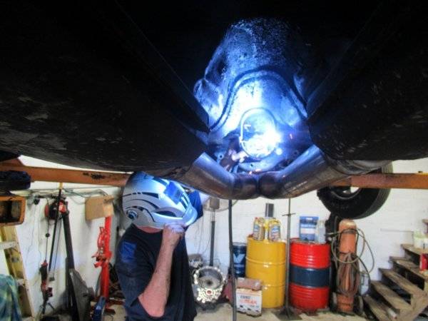

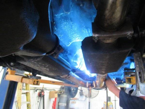

Alright Tim, I have this idea in my head and want to see what you think. I want to order the same loop but.....what do you think about welding it to the dual exhaust pipeing? I was thinking of cutting the ears off and welding the loop in between the pipes with access section still retaining the bolts. My exhaust from the header collectors, H pipe and to the front of the mufflers is removable. Seems like it would be pretty solid without drilling through the pass compartment.
I would think it would be pretty flimsy. Your exhaust only has one solid mounting point at the headers. All the hangers in the back are rubber suspension types. Plus your engine does move a little due to rubber motor mounts (unless you have solid ones). I wouldn't think it'd be that big a deal to remove the front seat and pull up the carpet.
If the front ujoint fails it isn't going to stop spinning till the car stops. That's a lot of abuse your asking of 5 inches of exhaust tubing. Just my 2 cents.
