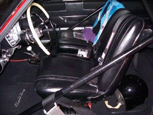

I installed my S & W 6 point rollbar myself. The bars came pretty much very close to being welded right in. But if you want to put then in a slightly different angle or position you of course have to grind the bars some. And my rear bars would have to be bent just right if I had put them through the rear package shelf. But I did not put my rear bars through the package shelf as I put them straight down where the rear seat cushion meets the rear seat back. and I did not bend my side bars any like I see may do because the rule says when sitting in the drivers seat the side bar should pass between your shoulder and elbow. But you do have to do some cutting , grinding and fish mouthing. And it is a lot cheaper to buy the kit and do it yourself then paying a shop to put one in for you. I only need a 6 point rollbar to be legal down to 10 flat. Right now my car has run 10.70's and even if I ever do make it faster I don't plan to go faster then 10.0 because I don't want to put a full cage in my street car. Ron

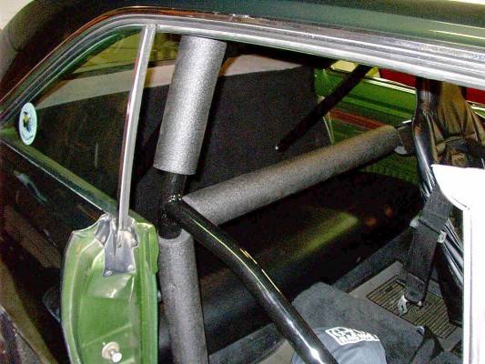

I cant find a pic of my rear bars but this is my sons Dart and they are done the same as my rear bars. His kit is a Competition Plus kit. Ron
