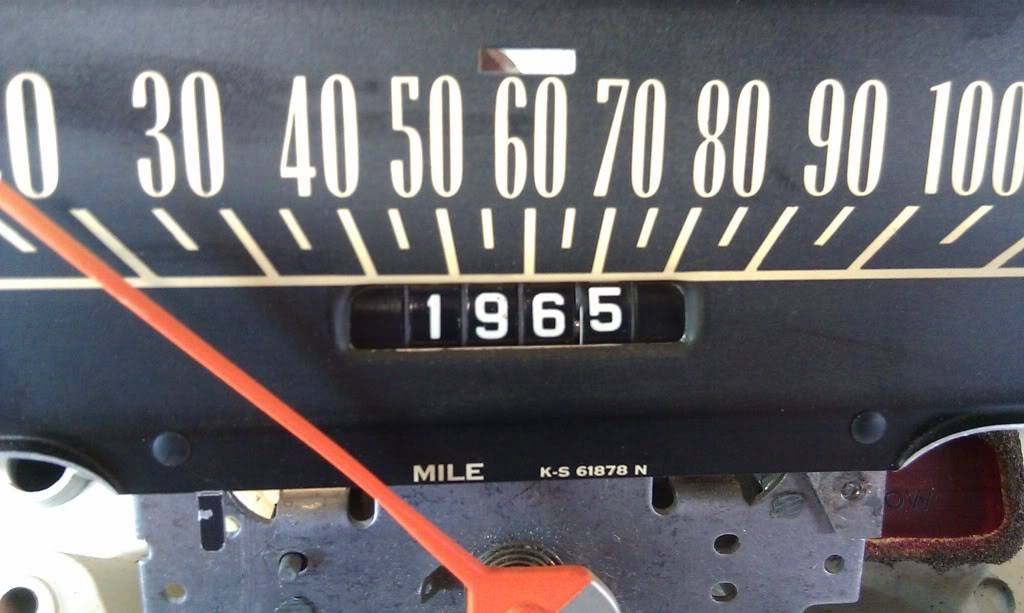

I also was messing around with the Odometer and came up with this. The speedo isn't hooked up anymore. Nothing big. No one will ever notice but it only takes one to make it worth the trouble.
