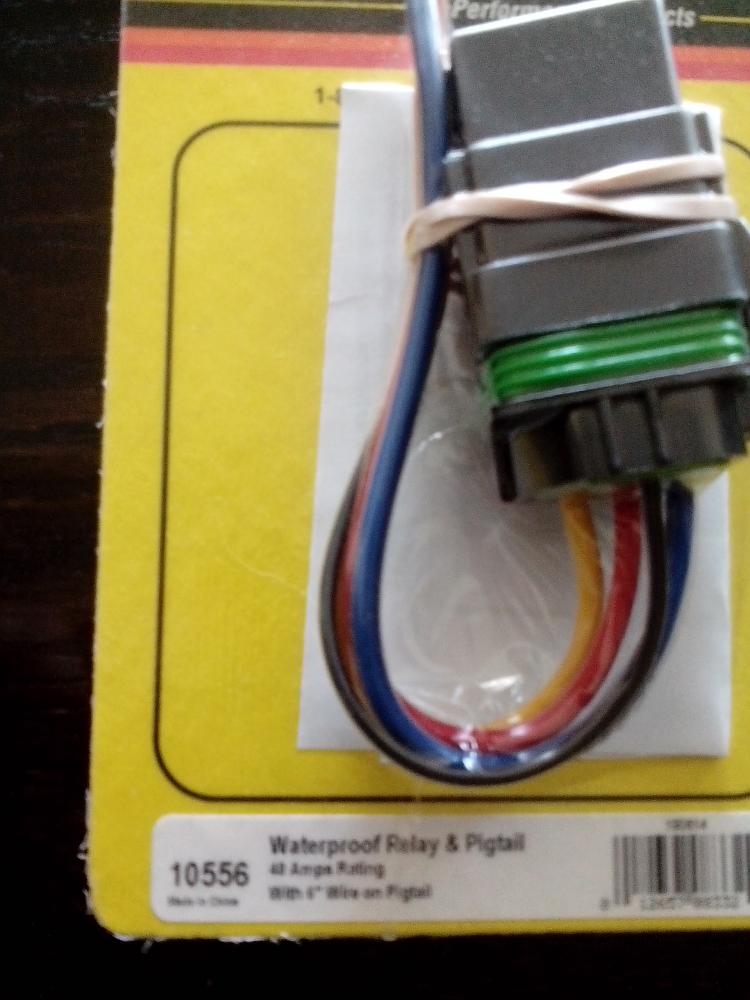

1407877468834.jpgWater proof ones from jegs 40 amps.. what im useing for relays every where horn lights wiper motor heater blower etc
those are just a GM fuel pump relay...and my Bosch relays are 40a as well
