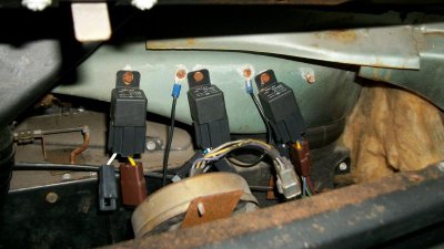

Hey folks! I need your help. I posted some pictures of the relays The relay on the left is always warm to the touch. It will also run the battery down. I'm sure it has something to do with the hideaway headlights. Is there something else keeping this relay energized al the time?

yea, probably the hold open switch is in the "up" position...flip it down and listen for a "click"......if you hear a click, means you have a limit switch issue at the front grille
Also, I will not warranty the relay set if have other issues causing these to burn out. I suggest a service manual as well

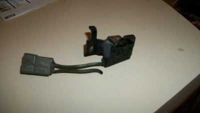

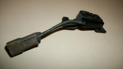

While I was looking for the hold open switch, I found this.The one wire was broken off. Now, what is it? I tried to upload photo's but, no luck. I'll keep trying

These are the pictures I was trying to up load. While following advice on finding switch. I found this. What is it?

that's a headlight limit switch in the front grille to stop the motors from turning...that being broken will not cause your relay to get hot..I bet you have another bad limit switch up front, or the buckets are out of adjustment to contact the limit switch...
again, I suggest getting a service manual on this system and read up on it...there are 2 pages of troubleshooting diagnostics in there for just the rotating headlight motor system
the headlight hold open switch is on the left side of headlight switch..it controls the ground to stop headlight motors from turning closed
