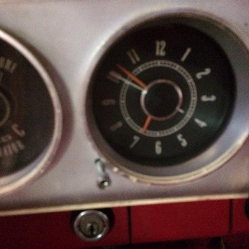

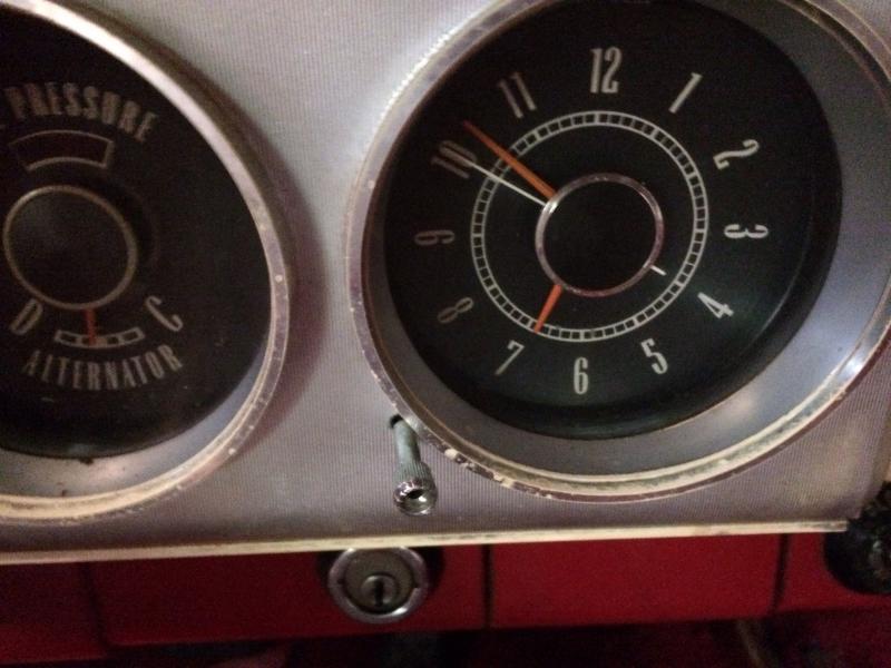

How do you remove the clock stem from the dash of a 1964 Plymouth fury? Is it an Allen head set screw?

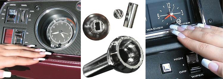

Use a small flat tip screwdriver to remove the special screw. Be careful not to lose it, as it is quite small.
Here's you a pic of the knob and retainer
