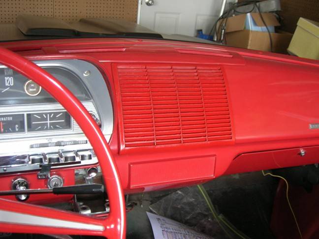

This was done entirely in place. The gauge cluster, heater control plate, radio plate and glove box door were obviously removed and done out of place but the dash frame remained in place. The only reason I did it like that is because it was an afterthought and the brand new windshield had already been installed. Like Dako said above, it requires a lot of masking off but as you can see, it can be done with pretty good results. Not the best photo but you get the idea.
