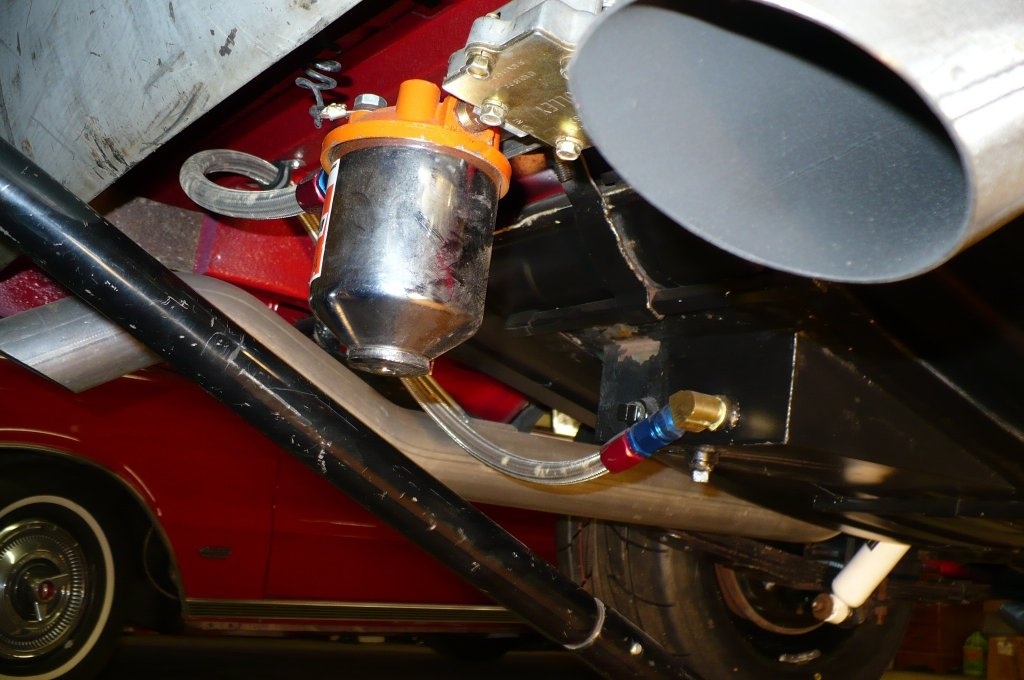

The Carter pump is the basic 7 psi no regulator. Had gas tank out at the time and brazed the mounting bracket to the passenger side of tank. There is enough room on my 66 Satellite. My 65 dodge no way mounted pump and filter behind bumper. No return line, 30 + yrs ago I never heard of return lines. The only problem I ever had was the wires falling off. Was 100 miles from home. Minute of panic then started to think. Crawled under car (I was skinny enough then) saw wire hanging down. Had some electrical tape in car taped wires to pump and all was good.

My 65 Dodge is far from stock. My 66 Satellite is, if the electric on that crapped out I'd just remove it. Picture of gas tank, pump and filter on my 65 Dodge. -8an to 1/2" fuel line to fuel block. Two regulator to carbs.
