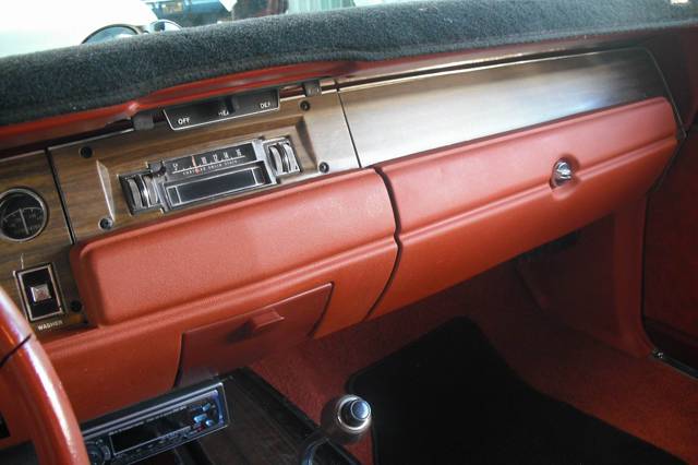

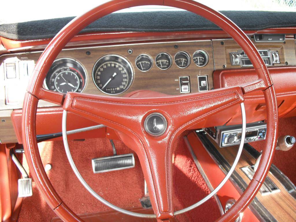

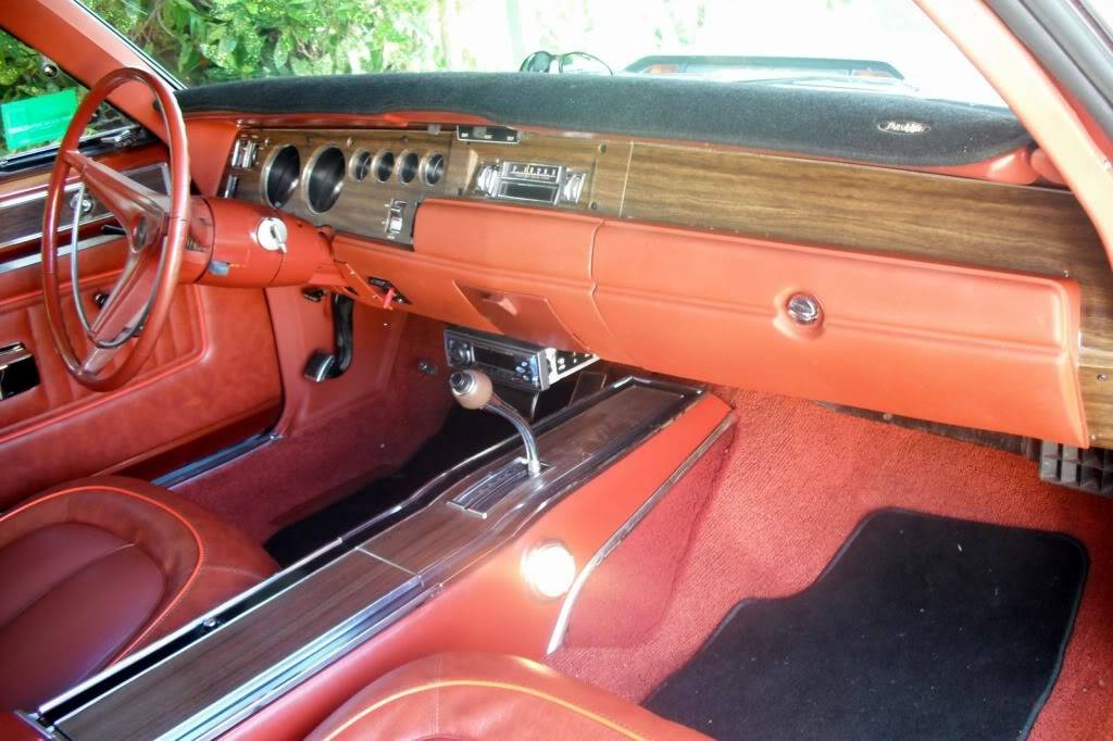

My 70 GTX had 2pak paint on most of the dash plastics [and also on the steeering wheel, A pillar and front A pillar speaker panels etc etc..[#!*#].
They looked lurverly [not] Real shiney orange like they were clear coated. What a dilema. I took my glovebox door to a Soda blaster to try, as It was the only replacement I had in for factory Orange interior. He blasted it and it did not effect the grain finish or damage the plastic at all. I took the other parts down and they all came out like mint originals.[No doubt he used a lower pressure setting] I need to do the dashpad and console next.
Id say no to chemicals and a definate yes to Soda blasting!
cheers Dave
before ...yeeesh!
You can see the dashpad is waiting to be restored, you can see the guy painted the pad too [double doh!]
Here you can see the plastics installed after the Soda blasting. They can look a little 'dry', but I prefer the tire shine look stays on the tires! Over-all its a 100% improvement.

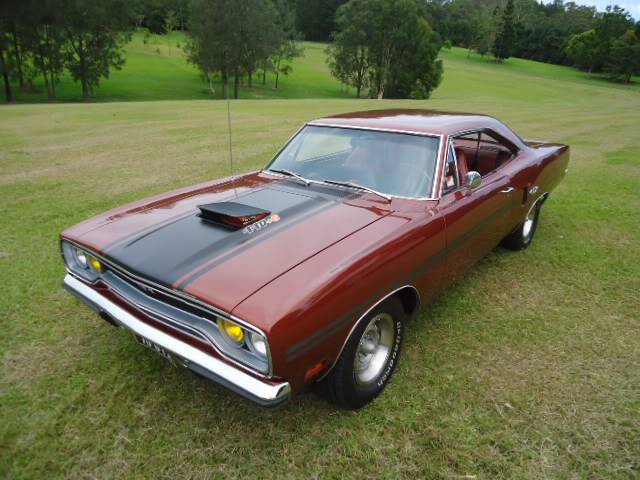

My 70 GTX

thanks orange interior look great! First one i've ever seen. What's exterior, burnt orange, Tor-Red, White?
