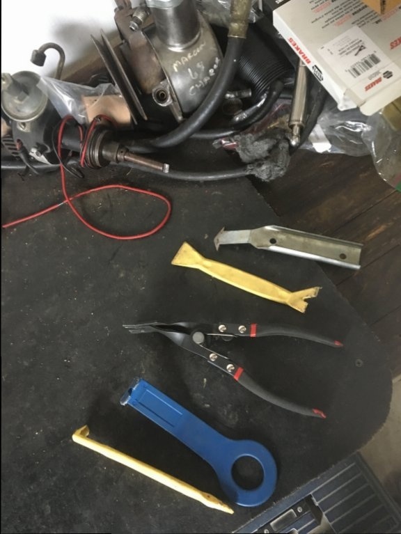

I use these tools all the time to pull trim off. I've done over 50 mopars and countless others.
However, the most important tool I use I cannot take a picture of....PATIENCE!!!!
The middle tool in the picture, I've been looking for one of those. Can you tell me the brand or where it came from? Thanks.
Might go down to a local auto glass outfit, and see if they have one of the nylon wedge tools you can buy. On these older cars, that nylon tool is what's used to both remove/install front, and rear glass. Still takes patience, but makes the job a little easier.
You'll have types of nuts, besides push in/pry out clips on your trim. Either way you do it, suggest you keep track of every clip/nut, for each piece of trim. Some of them will take two, or three different ones, at certain locations on the body.

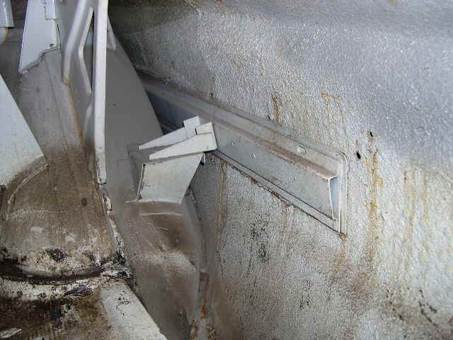

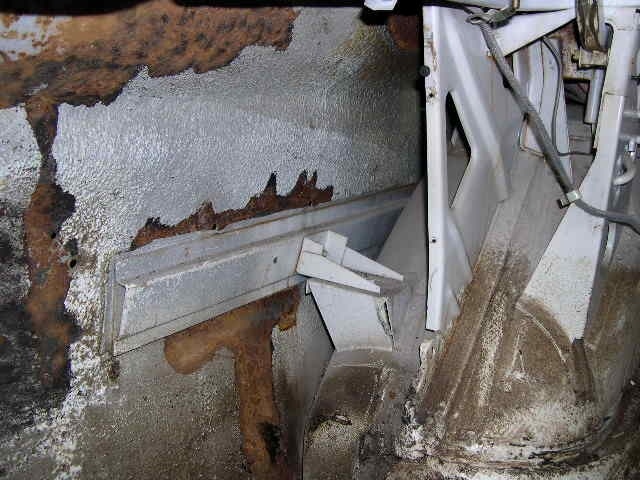

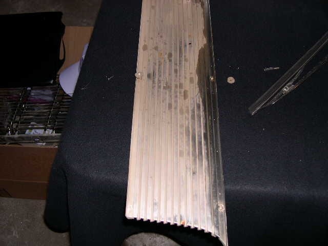

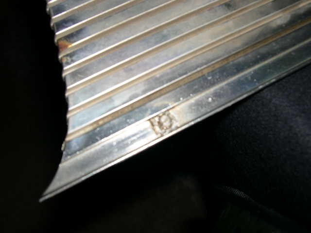

Thanks much for this info! That was a huge resto on your Plymouth! I'm lucky mine is pretty solid having lived it's 1st 26 years in Pasadena and never driven winters. I have about 3 studs that broke and a few I ran across more that were already broke. The worst is the r. rear alum back panel 4 of 6 are gone so trying to figure out how I'm going to fix this. Inside the trunk on the quarters lot's of surface rusting and coating to scrape out so I can treat the metal and put on new coating before repaint is done. Posted couple pic's on this (inside trunk) and the rear panel I mentioned. As for the windshield, I just need to remove the chrome trim around it having most concern taking off the cowling/bottom piece w/o damaging it. I'll post couple more pic's..
