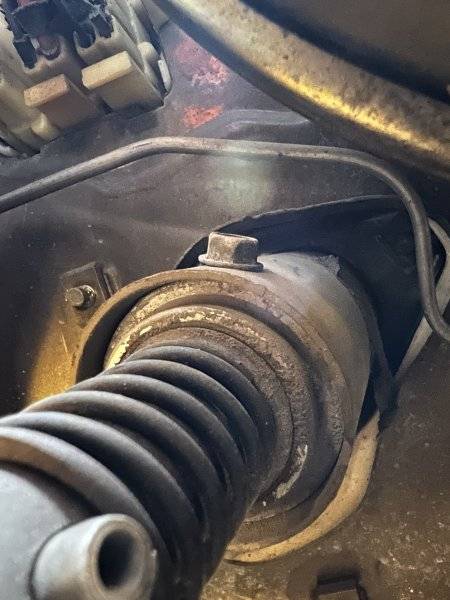

Thanks for the reference. It got me thinking of the lower bearing mentioned in the postsing. I took a look at what I have. I'm not an expert but it looks like a bearing up inside the steering tube on the engine side of the firewall. I'm thinking I don't have to worry about centering. What do you think? Is that a bearing in the photo?
Yeah that looks like a bearing but someone else can chime in. I used a metal roller bearing when I rebuilt my 71 steering column.
