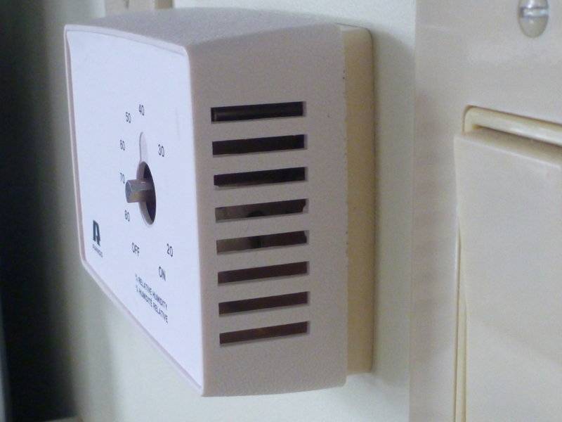

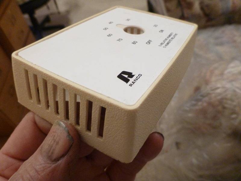

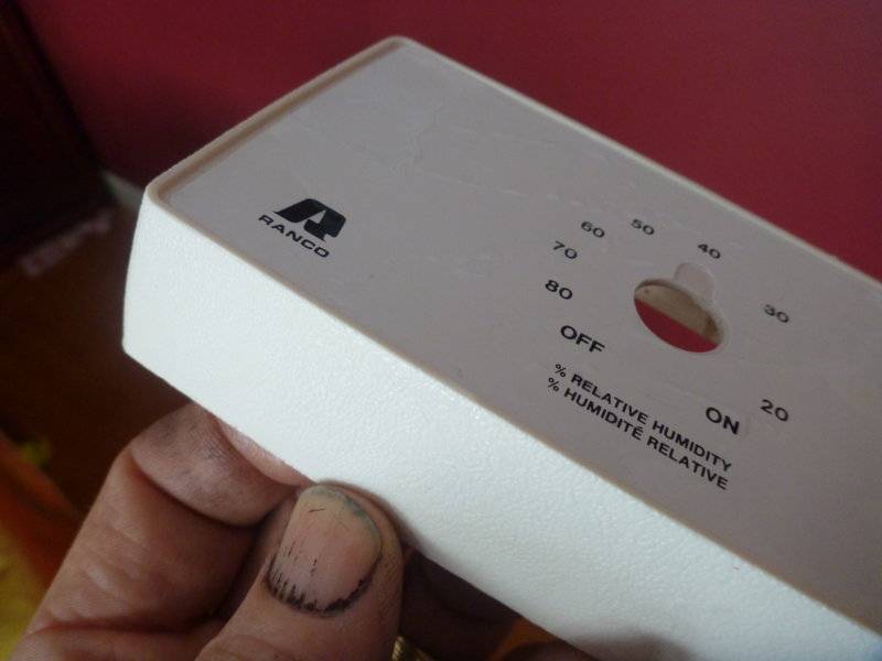

I did my humidistat cover and the wifes cutting board strainer to turn them back to white from yellow. Seems to work on some plastic and not others.
All I did was coat them in 30 volume (9% Hyd Peroxide) Emulsion cream, put them in a zip lock bag and hang in the South facing window for a few days.
