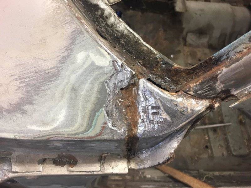

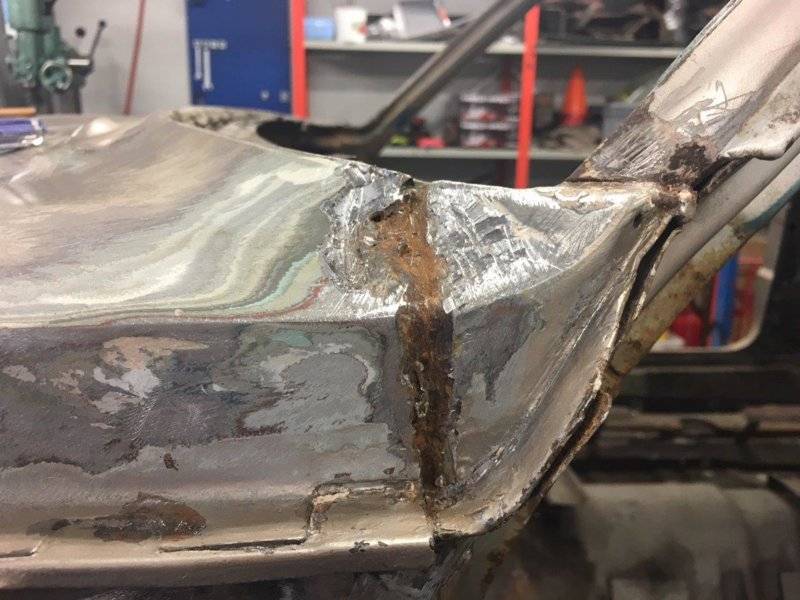

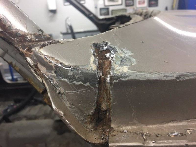

I could see small small cracks in the area between A-posts and upper cowl on my Coronet -66. I thought it would be easy to blast the area and weld the cracks, BUT I discovered a lot of lead in the area with rust under it... Now I have understood that this is how it was done from the factory? The cracks should be quite common here I guess? How have you done your repair work? All experiences and pictures would be appreciated.
I melt it out with a propane torch, clean up the rust, weld anything that needs it...…… fill it with either all-metal (I prefer marine-tex) go over it with some filler and move on...…. make sure surface is nice and "rough" so all metal grabs, then make sure the all metal is rough so the filler grabs...….. I have had adhesion issues with all metal, under and over
Well, I'm semi-retarded and put the lead back (ahem, usually) but whichever way you go, I concur with the boys above, you'll need to dig the lead out and make your rust repairs first.
Thanks a lot for sharing your experiences. I think I will go the way, blasting-welding-priming-fibreglass filler-filler-paint...
All metal fillers will be more stable in the long run. If your fiberglass fill is too thick it may come back to haunt you. For the service these cars see after they are restored either would be fine.
I don't know about the glass and resin, I don't think it has enough bonding strength
to hold up! I would melt out all of the lead, wire brush the rusty areas untill it is clean,
and put some "Johnson's Tinning compound on the base metal to "Tin" it. Wipe off
all of the black acid with a damp cloth and then star "puddeling" some lead or tin
filler metal back in with a small gas torch (not propane). I use a Victor J-27 with a small
tip as not to get too much heat. When finished, it will be a very strong joint. Again, the
factory used this material because it was the best for bonding and held up this long.

The key to that type of repair is getting it cleaned up with the rust removed to clean metal. If you don't and most won't have lead to replace damage with. I would go with the marine filler for the deep repairs then final top coat with high quality plastic filler. Having a nice v shape to the channel is also helpful more surface area for the repair to stick to. I would carefully look at the windshield channel also suspect water getting in between lead and parent metal, lead doesn't rust.
