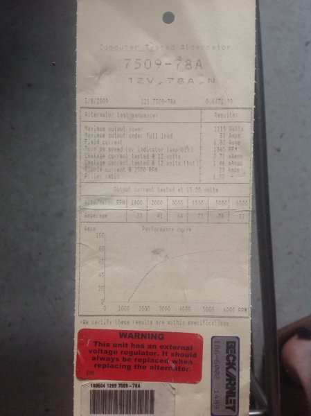

Maybe the 78 amp unit that came on the K cars. Back in the late 80's/early 90"s, that was an upgrade suggested on Mopar Action. I put that on my 70 Challenger. Pulley was different though but thats an easy swap. Going more than that, it would be a good idea to upgrade the wiring.

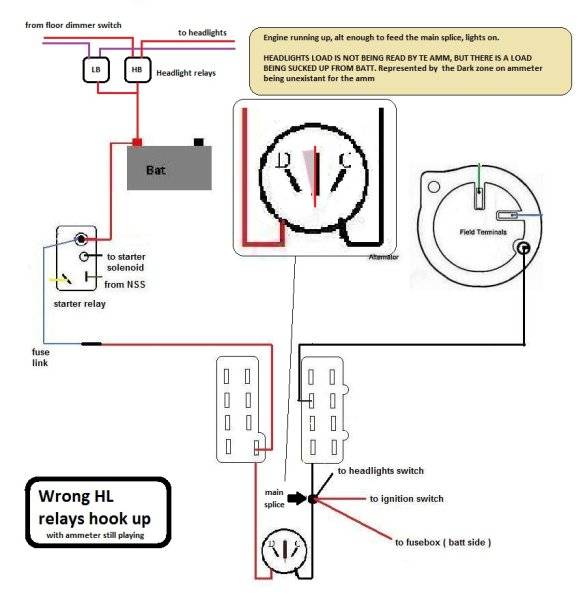

This could be a good option on the cheap, which with the propper pulley size (the one used on 80s alts) will be able to source up to 45 amps at iddle. Very important load capacity to feed the A/C blower along with some other accessories. Still a bit short if raining and needing to turn on wipers with A/C on (depending on blower speed selected thought) at a traffic light on nights.
However, like mentioned I still would advice get AT LEAST one straight path between alt stud and ammeter withouth going throught the bulkhead. If you are keeping the factory one throught the bulkhead, add a 12 gauge extra path won’t hurt. Not a huge or hard to make upgrade, just add one wire. But still check the factory charging circuit conditions at bulkhead.

These alts are around couple of millimeters wider and fits a bit tighter. On my 74 400 at least I had to get a longer belts setup because the rear of the alt was meeting with the block, so a longer belt will sway the block. Also had to grind a bit the rear spacer for a better belt alignment ( more reason to get a longer belt setup).
For a 68 if still using single field alt, using this alt will need to ground one of the alt brushes.

I am planning on doing the ammeter bypass at some point as that seems to be something a number of people on this forum are recommending. I did buy and install the headlight relay kit from crackback.
No need to bypass the amm, just source correctly all the accesories… and I would check the ammeter itself, not just outside but inside disassembling it.
My Charger is (was untill I dissasembled for a deeper resto job) a REAL daily drive car with A/C with stock system including ammeter… with that 78 amps alt and everything sourced correctly. Including halogen headlights with relays system, trust me. The amm needle barely flicked.
Also installed relays for each one of the blower speeds.
Those amm bypass recomendations comes mostly from ppl who don’t understand or don’t want to understand how to make it to work propperly. Or are still affraid about it.
