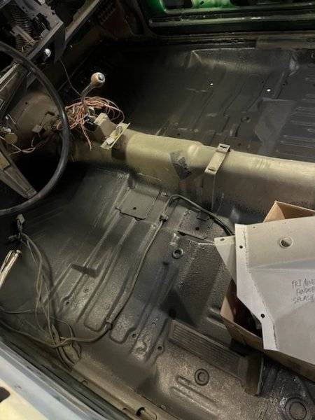

Chiming in here as my Charger will be released from paint jail hopefully in the next few weeks. I just had full front floor pans installed (AMD) and everything fully sealed and sprayed with bed liner, above and below. I'll be installing carpet over this, no need to paint it beautifully only to hide it with carpeting and break the bank. I've been reading that it's not necessary to add more sound dampening/expensive Dynamat if there's already a liberal application of bed liner. Might it also be unnecessary to go with the mass backing for the carpets?
