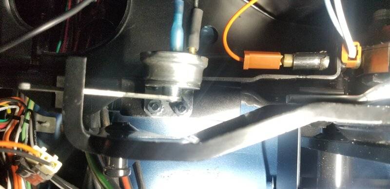

In doing my 4 speed conversion, the one piece I was missing was the clutch safety switch.
The only place I could find one was through Brewers and he was asking $250 if I had a rebuildable core, which I don't.

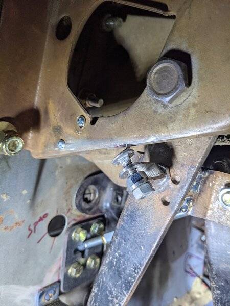

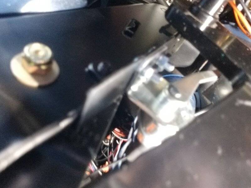

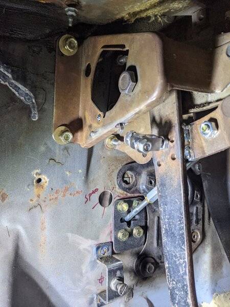

What I did was buy one of these:
https://www.amazon.com/gp/product/B003C01FFY
All I had to do was fab up a small bracket the bolted to the original location (no additional holes), connected the ground wires and it works like a charm.
I'll try to get some pics later
Here is what I did..
